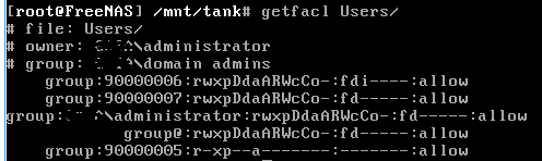

Elegant
Aug 27, 2015
67
Attached is my getfacl for the share. Although the administrator is the owner it is due to inheritance. The unofficial owner would be the intended user who I would set with uid=${UID},forceuid. Thanks!

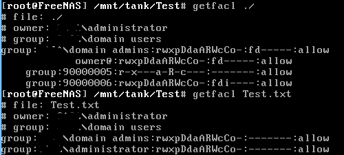

No worries, I read up a bit more on setfacl. I added in my flags for owner@ which was missing entirely (hence the lack of user permissions). I added the fd flags to the owner@ ACE but it is not applying to sub directories and files when I create files in Windows. If I create the files in FreeNAS everything inherits correctly; I have since created a new storage and created a new share to ensure I am working with something fresh.
Any thoughts on how to make Windows obey the new ACLs? It doesn't seem to be a fan.

Elegant
Aug 27, 2015
67
I'm doing this through my VM and testing on a new share with nothing on it; that's where I'm noticing the issue. I grasp that if you I simply type find /mnt/Tank/Share/ -exec setfacl -m u:owner@:full_set:fd:allow {} \; that all current files and sub-directories within will not inherit the new ACL without propagating (apply recursively).
Let's say I add the ACL to /mnt/Tank/Share/foo and then I explore to directory foo on Windows. If I create a file or directory within foo I should expect that file to inherit the ACL from foo. The issue is that this is not the case, nothing created within foo is inheriting the owner@.
In my last attachment, Test.txt was created after /mnt/tank/Test was assigned owner@ and it did inherit. The same issue occurs if I did that in /mnt/tank/Test/foo where foo also receives @owner and then Test.txt is created on Windows. Test.txt does inherit owner@ in either case despite the ACLs.
I fixed the commands in my previous post (they were wrong), and verified that they inherited correctly on new files / folders created via Windows Explorer (they did). ACE ordering can be an issue in samba. When you view your share definition in /usr/local/etc/smb4.conf file, you should see the entry zfsacl:acesort = dontcare. It is possible that this doesn't work quite right. This is the reason why it's generally a good idea to only manage ACLs from windows or through smbcacls on a *nix system with samba installed... and don't remove the ACE for owner@ or group@.
