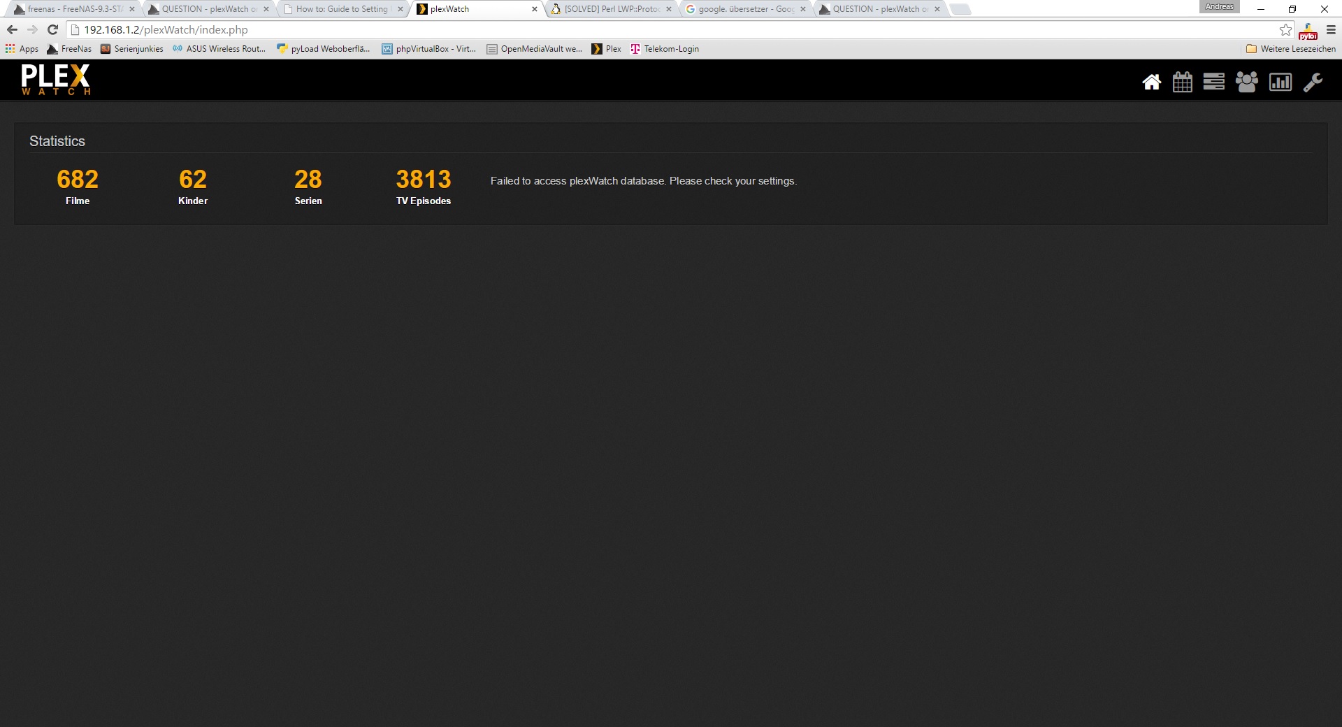

Hello,
i tried to install plexWatch on a freenas jail. So far it works. I can access the dashboard and configure the settings. I see the numbers of movies, series and episodes. But i got an error about the database file can not be accessed.
I have set the permissions to user www:www and tried 777 and 755. Without any success.
Perhaps can anybody help me to solve the problem.
Thank you

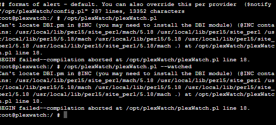

hi,
i do the complete installation again. I have troubel in the front end of the guide you have posted to get
install LWP::Protocol::https
whene i try the script
/opt/plexWatch/plexWatch.pl
i got the error
501 Protocol scheme 'https' is not supported (LWP::Protocol::https not installed)
Content-Type: text/plain
Client-Date: Mon, 14 Sep 2015 18:00:49 GMT
Client-Warning: Internal response
LWP will support https URLs if the LWP::Protocol::https module
is installed.
Protocol scheme 'https' is not supported        ...propagated at /opt/plexWatch/plexWatch.pl line 3814.
but the main problem is (see screenshot)
Have you installed the front end of the guide?

i got fixed it by:
pkg install p5-IO-Socket-SSL p5-Net-SSLeay p5-Crypt-SSLeay
