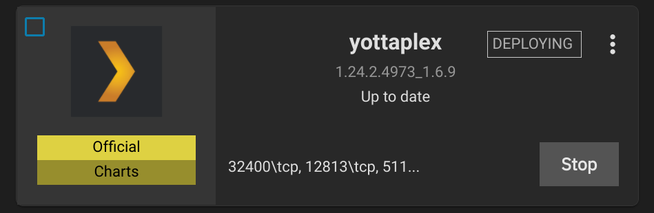

I had the Plex docker running fine, and could access via HTTP locally. But I could not connect to it with HTTPS, including from plex.tv and from Android app (it was reachable from outside).
I read on the Plex forums that there was an issue with migrations of the metadata/settings sometimes, that you had to logout and login again locally, and that would resolve the problem.
So I did that, but of course that means I had to add a claim ID in order to get into it again, due to the way the Docker image works.
This still didn't fix my problem. I then set the Plex secure network setting from Preferred to Required. After that, I have been unable to get into it again. And it is now stuck on "Deploying."
Further, I even deleted it entirely, then added it again, reusing my settings dataset. It still is stuck on "Deploying..."
Here's the log:

2021-09-12 23:50:33.671557+00:00Critical: libusb_init failed
Any ideas here??

Turns out this only happens when I have attached my config dataset to the docker configuration. It worked originally, so I don't know why it's hanging up now.
This is a migrated Plex metadata config from a BSD jail (not the PBI). I've recreated the dataset and copied over the data from the BSD jail again, chown, etc., and will see if this helps.

I followed my plan in comment #2 and everything seems to be working perfectly now.
The one oddity I have noticed is that the container indicated "deploying" status several minutes after Plex Media Server was being shown in top doing its thing; and until the state switched from "deploying" to "active," I could not access the web UI (portal), even though I knew the URL (i.e., I wasn't just waiting for the Portal button).
