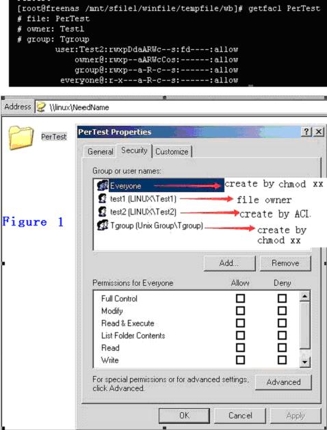

After I add Auxiliary Parameters , permissions ( which created by ACL) disappear
Before I add Auxiliary Parameters, it’s permissions as below(figure 1):

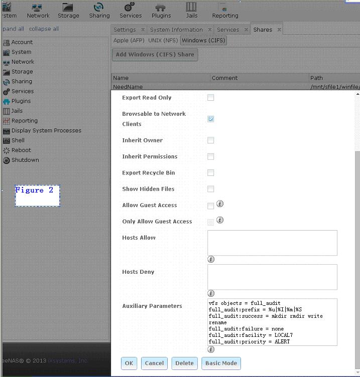

Because I want to record who/when loggin/modify/delete my share files,I add some “Auxiliary Parameters” (sharing—windows(cifs)—edit-advanced mode-Auxiliary Parameters)
vfs objects = full_audit
full_audit:prefix = %u|%I|%m|%S
full_audit:success = mkdir rmdir write rename
full_audit:failure = none
full_audit:facility = LOCAL7
full_audit:priority = ALERT

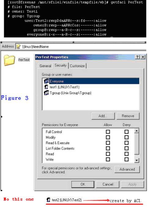

After I added Parameters and restart cifs services ,it’s permissions as bellow(Figure 3),Permissions (show on windows explorer) created by ACL had disappear:

Samba allows extending its core functionality through modules called "vfs objects". Samba only allows one "vfs objects" line per share. When you added "vfs objects = full-audit", it effectively disabled the previous entry "vfs objects = zfsacl" which handles ACLs. The solution is modify your line "vfs objects = full audit" to "vfs objects = zfsacl streams_xattr full_audit". If you want to do shadow copies, then you will need "vfs objects = zfsacl streams_xattr full_audit shadow_copy2".
