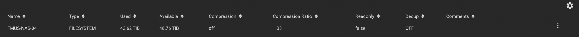

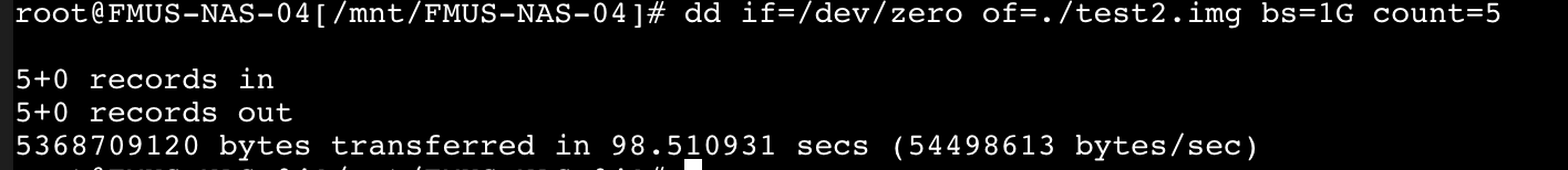

Mom-frlm
Feb 18, 2021
6
No - compression is turned off.

Rand
Dec 30, 2013
906
Performance is not actually good, sorry, didnt actually calculate.
First example were 280 MB, second is 50, so not the usual compression effect (huge numbers on old spinners)
RaidZ with a single write process will not be fast in the first place. Tried fio with multiple processes?

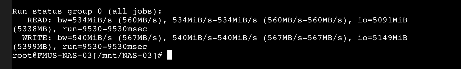

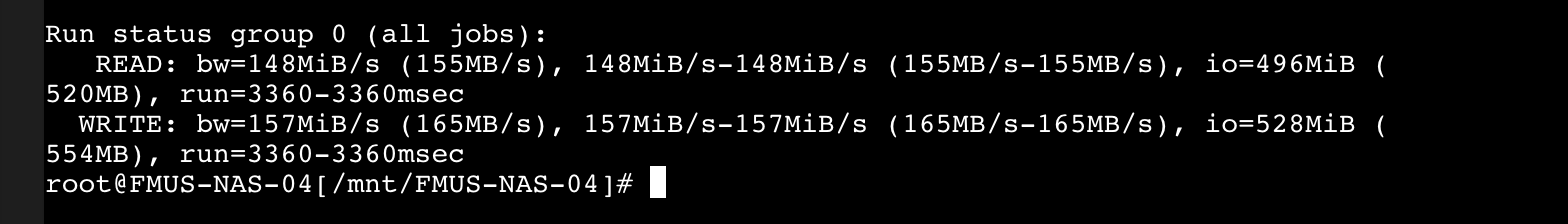

Did some additional tests. We have a second - almost identical - server. There's less storage (16x 2TB) in it and less ram (12GB).
Nevertheless, this one performs much better (560 MB read/write). The main difference is:
In the faster system the hardware RAID controller handles the discs and TrueNAS sees just on disc.
In the slower one the 16 discs are managed by TrueNAS. I thought that was the recommended setup?
blanchet
Apr 17, 2018
516
Using a RAID controller is not the recommended setup, because everything is delegated to the RAID controller. TrueNAS cannot detect issues on disks. For example, if a disk fails, do you receive an email notification from the RAID controller ?
A 16-disk wide vdevs is a very large vdevs. It is ideal to maximize disk space but it ruins the performances
A pool with 2x 8-disks wide raidz2 would have better performances (more IOPS).
