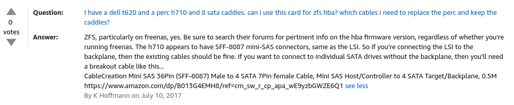

Hey! Thanks again for your expertise. Can you confirm, that this HBA Card will completely fit and work with my Dell PowerEdge R620? I have already bought the Cables but need a Plan B, of course.
Thanks!
artlessknave
Oct 29, 2016
1,506
I do not have a r620, however, there are standard PCIe slots so I know of no reason to think it wouldnt work. you should also be able to replace the h710 in the dedicated storage slot, but unless you need all the pcie slots you can just use a pcie and have both cards in the system
artlessknave
Oct 29, 2016
1,506
i cant read that but it should work fine. it's branded LSI so it should be a legit LSI card at least. there are often major problems with the dirt cheap chinese clones of LSI that show up on ebay alot
