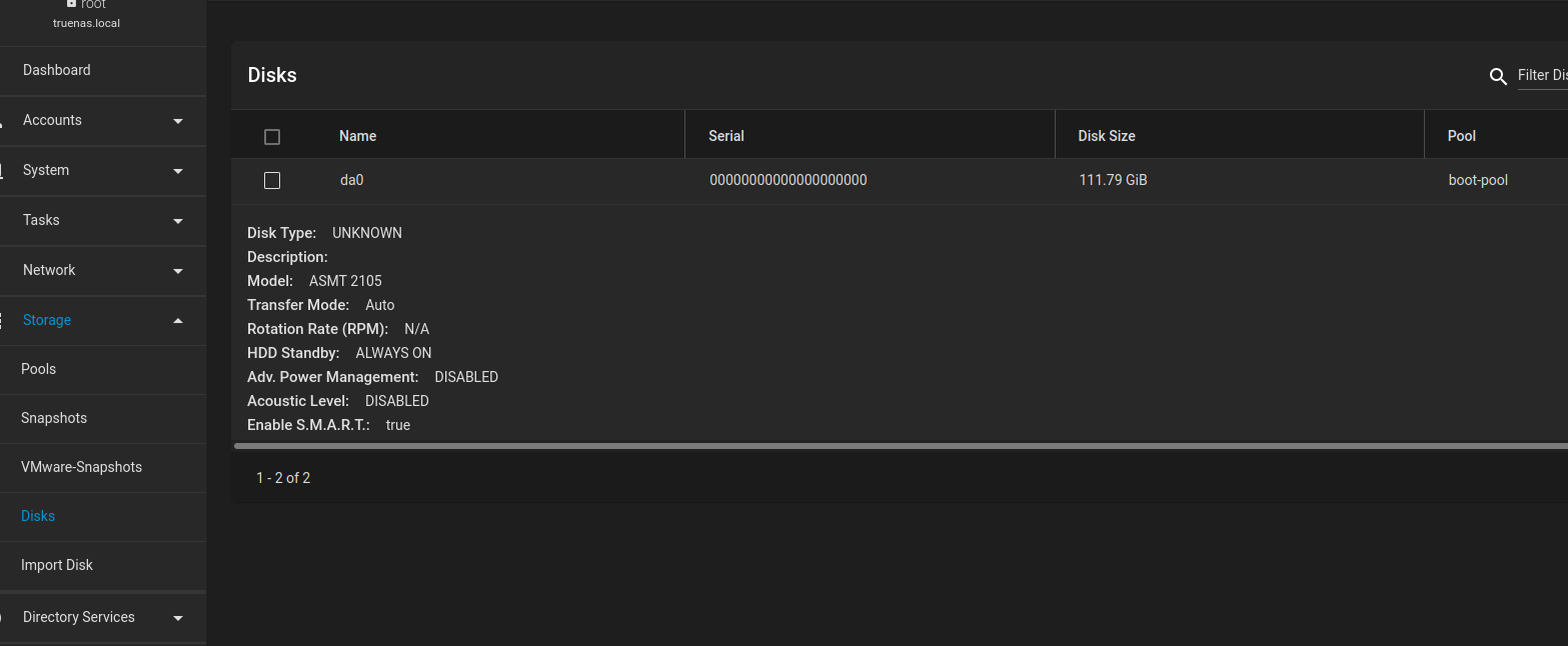

As boot I have now a mirrored pool of 2 SSD's
Samsung 128gb on SATA
corsair 120gb on USB
but the USB drive behaves strange:
truenas doesn't see that its an SSD drive for example: and the model no is ASMT 2105
potentially how much of a problem could this be?

Irgendjemand5
Sep 20, 2021
14
Sounds like the model number of the controller. Seems to be a USB/SATA bridge chip.
Ok,
And is that potentially problematic that truenas doesn't recognise it as an SSD?
t's over a usb 2.0 (no 3.0 available)
Should I get another ssd to usb connector part?
20,175
What kind of special recognition do you expect it to need? The real question is whether SMART data can be queried without hassle.
I was thinking that maybe if truenas thinks that the SSD is a HDD it might talk different to it and might destroy it in the process? That's why I was asking.
So I will check of the smart data can be read out fine. If yes I leaf it,
If no I get another sata to usb
20,175
No, that's not really a concern in any sane environment.
