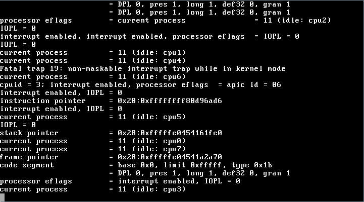

Everything seemed to be running smooth for a day. I get an update for U4 and now i'm getting crashes again I managed to screenshot the fault. Does anyone else get this issue I attached the screenshot
