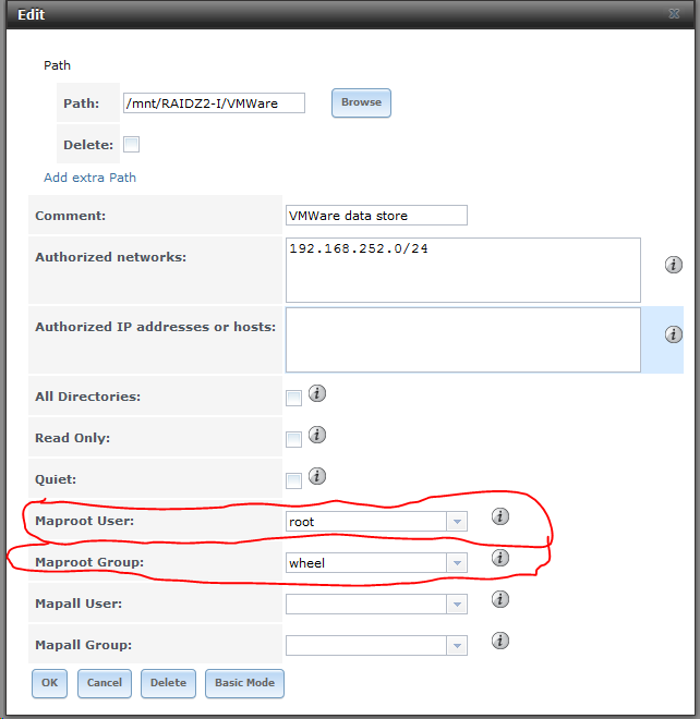

How is your share defined? I suspect you are missing the "maproot" options.

Elliot Dierksen, Nope this is what i tried.
the issue exist only when there is a dataset set on the folder i am sharing
