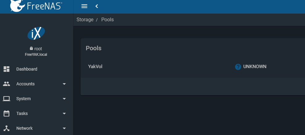

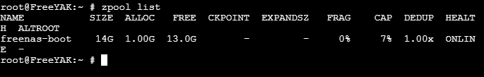

I just rebuilt and installed the latest 11.3 stable release on my gear and restored my backup config. I am able to access the GUI & Shell and see the disks, but the install and subsequent restore did not auto import my zpool. I am not a FreeNAS expert and while I have fumbled my way through tutorials and FreeNAS since v9 I would consider myself a noob.

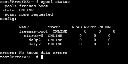

ZPool list shows the following... where are my drives?

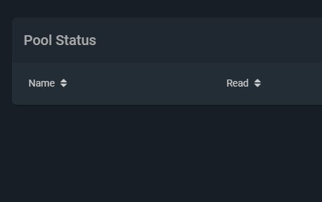

Zpool Status shows the following

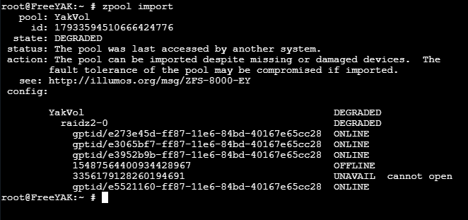

Zpool import shows the original Volume is there and potentially can be imported. Degraded because the original failed drive hasnt been resilvered yet.

How do I import the disks so that FreeNAS recognizes them? When I go through the GUI it shows the Pool as unknown, but status is gone completely.
What have I done wrong and how do I correct and restore my data (if possible)?

Do a zpool import -F YakVol (-F since it wasn't exported properly from the old system and you're missing 2 disks)
To get it back in the GUI, zpool export YakVol then import from the GUI.
Ideally, do something about the missing disks before all that (check cabling?).

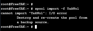

No, this should use -f (lower-case). The -F flag is intended to repair damage.
I'll try that now... thanks. Not sure about missing 2 drives though. When I run a GEOM list disk, it shows the 5 active drives. I haven't connected the 6th as I was waiting until the pool came before resilvering.

9,700
I'll wait for @danb35 to comment, but maybe you can get it to import with the -F in its current state.
Better would be to have 5/6 disks online and try with that.

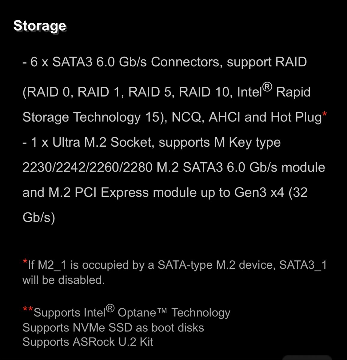

So looking at that motherboard, the specs have it showing only RAID0 not ACHI or JBOD mode.
So first you should verify that it’s configured correctly for JBOD or ACHI if possible. Otherwise per the link, you need to find a seperate data card that support its cause you don’t want to be stuck requiring a raid

The pool should come online with two missing disks--it's a RAIDZ2 pool. But the I/O error looks bad.
So I ran the following command:
zpool import -FfmX YakVol
Andit looks like the pool came back. I just have to resilver the replaced drive.

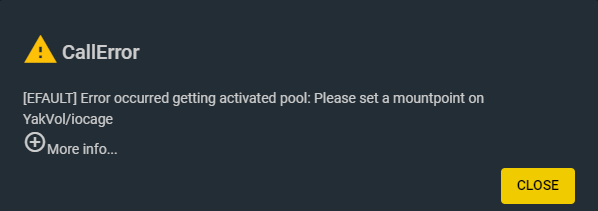

But now I need to set a mountpoint for my iocage as it seems the restore didnt bring along the jails...
So first you should verify that it’s configured correctly for JBOD or ACHI if possible. Otherwise per the link, you need to find a separate data card that support its cause you don’t want to be stuck requiring a raid
Josh - Actually it does support AHCI as long as I dont use the m.2 drive.

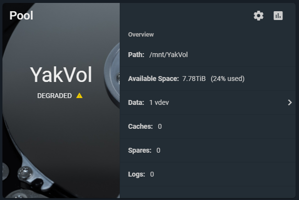

Resilver of drives completed but encountered another degraded drive and now the pool only shows 7.83 TiB Free out of the (6) 3TB drives installed.
Shouldn't this be at/around 11ish TB of usable space? Or is FreeNAS removing the degraded drive from the pool and reducing capacity? I thought that was what the 2 spares were for?
Also, SMB service isnt starting which is preventing me from creating mountpoints for Plex and creating datashares to Windows clients.

Update 2
This morning I deleted my restored configuration and configured Freenas 11.3 from scratch. Exported my "degraded" volume, and reimported and now it is showing Healthy. o_O
Reconfigured/added my SMB shares and configured Plex.
Closing out. Thanks everyone for the assist.
