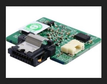

Also , this is the first time i have heard of SATA DOM , so if someone could shed some light on this .
DOM stands for: Disk On Module (pictured is a Supermicro model)
It plugs directly into a SATA port and also needs 5v power,
the methods to connect to power are many and varied.
These are fairly popular for a boot device in FreeNAS.
