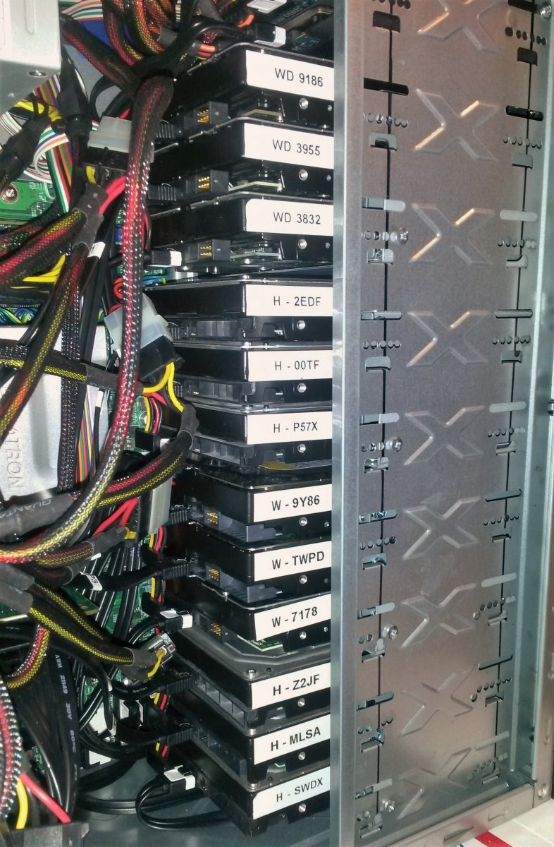

I run one of my systems with 16GB and you will probably be fine with that, at least to start. I have 32GB in the other one so I have some room to run Jails. If you decide to run more jails later, you probably want to upgrade, just to give yourself some room to 'play'.
It all looks good though. As you are assembling the system though, you might want to label the drives where you can see the label to tell you the last four digits of the hard drive serial number. It won't likely matter at first, but later when you get a drive failure, it will make finding the correct drive much easier.
