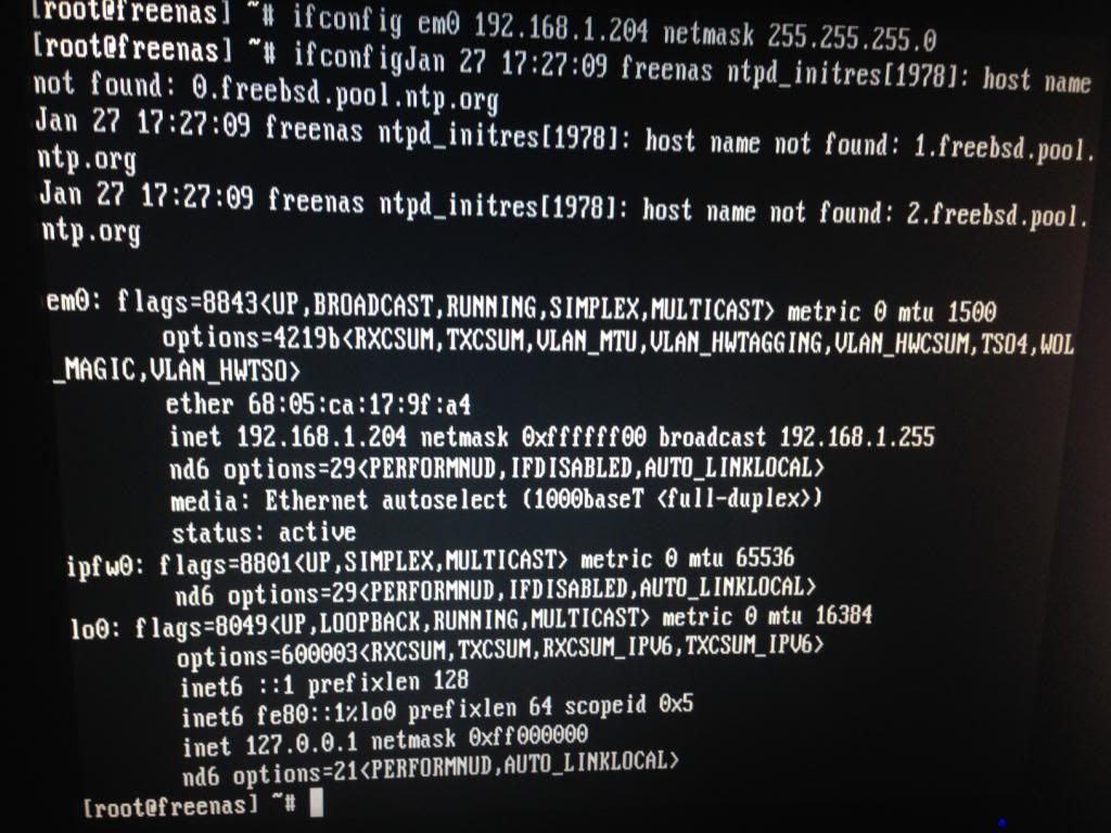

What I get from Shell after fresh boot:
What I get from "IFCONFIG":
What I get after I force a "IFCONFIG em0 192.168.1.204 netmask 255.255.255.0":

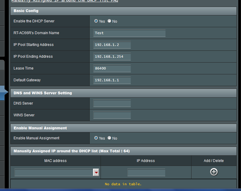

ASUS RT-AC66U DHCP Settings:

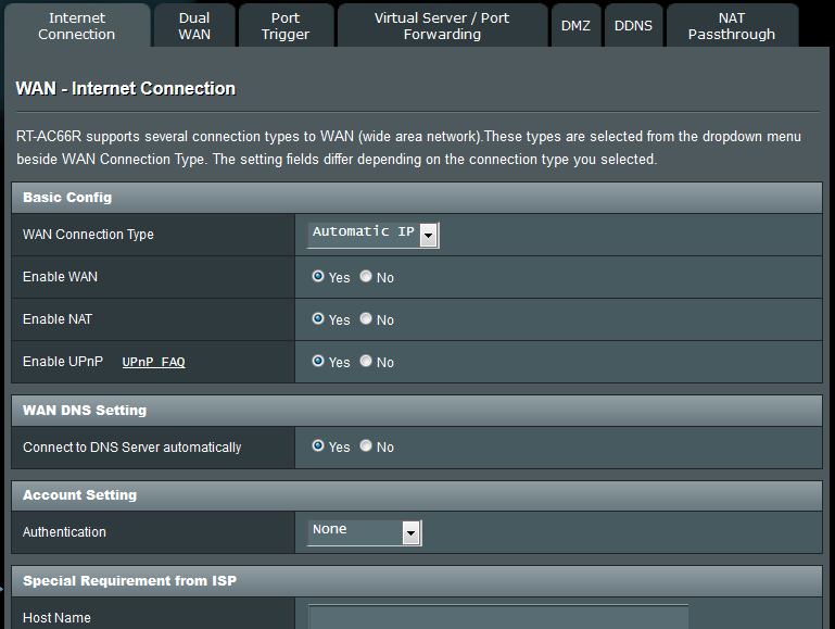

ASUS RT-AC66U WAN Settings:
