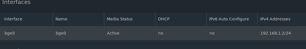

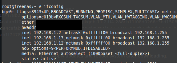

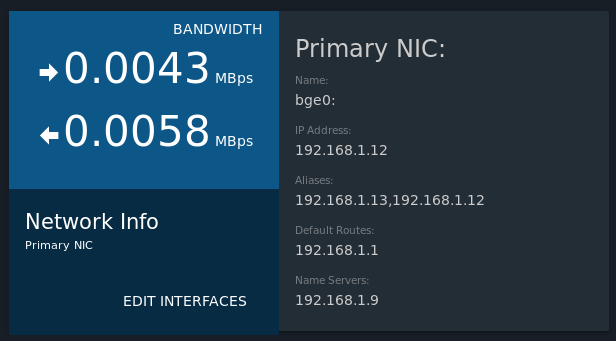

Hi all,
Wonder if anyone else is experiencing this? After a reboot to replace some drives, my Freenas server seems to have stolen the IP of one of my jails as it’s own despite having a static IP assigned. I also noticed that it can also sometimes grab an IP from DHCP too which is find extremely odd. The freenas machine also seems to be showing the jail IPs as aliases which it’s never done before and is not actually showing the main statically allocated IP on the dashboard.
The problem I have now is that the jail who’s IP it seems to have stolen is that of my Plex server so none of my clients can acces it as they think they are accessing the freenas box itself.
I’ve never come across this before but wonder if it’s a known issue and if not, is it worth raising a bug report?
EDIT: Added images to show issue

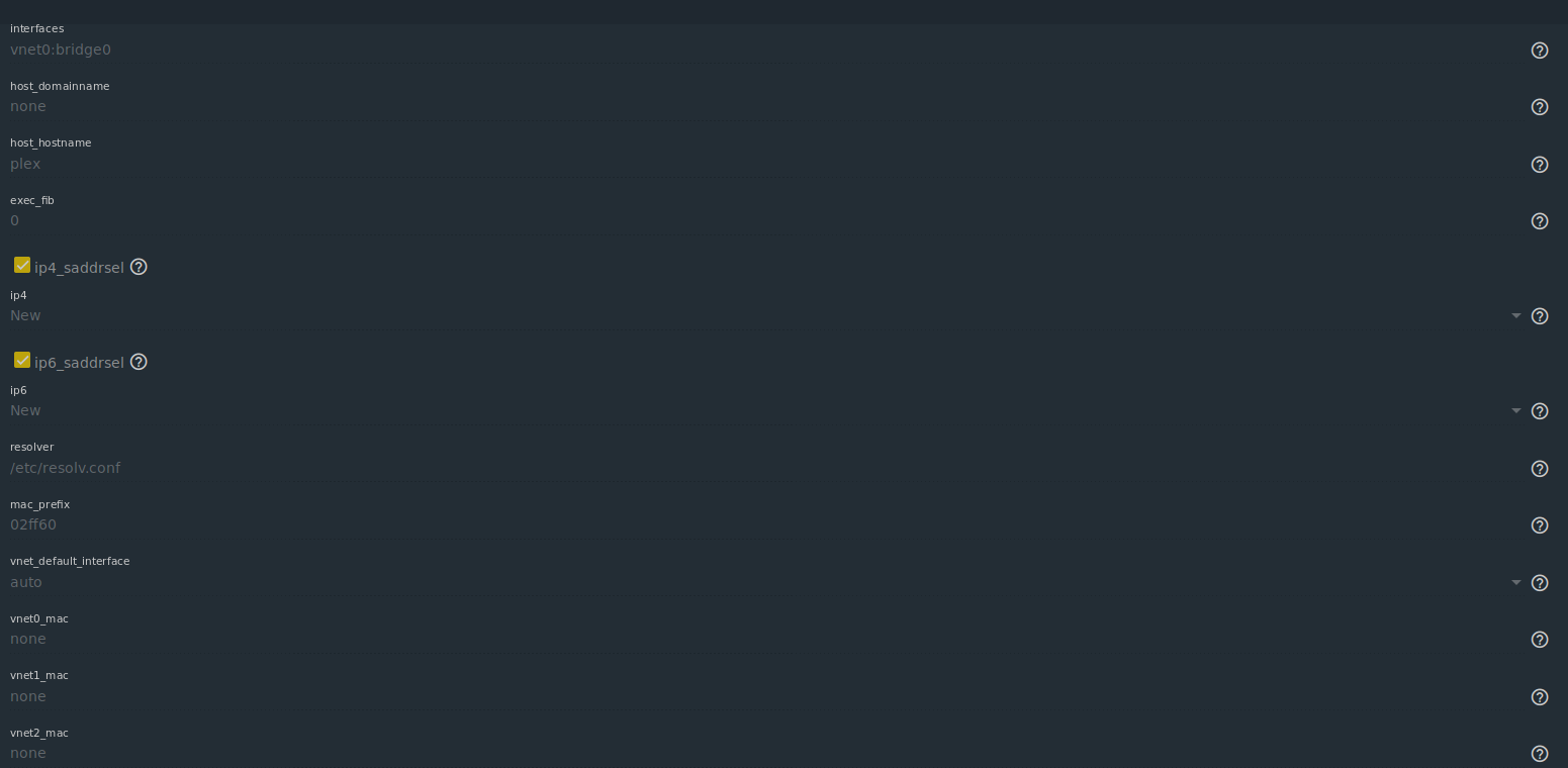

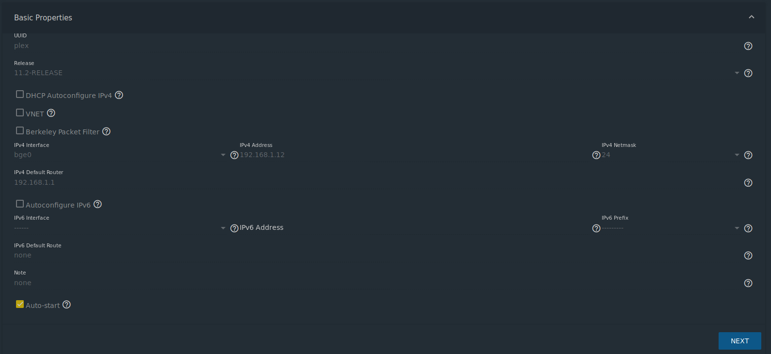

Attached, cheers.

pschatz100
Mar 30, 2014
1,184
It looks like you have your jail set for a shared IP, so yes... the system is doing what it is set up to do. However, it does not look like you have all your networking parameters set up properly.

Them you should try enabling VNET on your jail. working through the new GUI:
1) Stop the jail
2) Tick the use VNET box in the jail properties
3) When using VNET, the IPv4 interface should be set to VNET0. Make certain the Address, Netmask, and Default Router are set properly
4) From the Network Properties, check that the interface is set to something like: vnet0:bridge0 or vnet0:bridge1. The exact value will depend on your system, but will likely be one or the other.
5) Once everything is set properly, then start the jail.
I set up my jails by hand, so I have not used the GUI to set up jails but it looks like everything you need is there.
