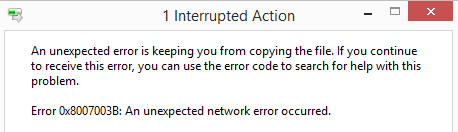

My USB key died and the NAS sat for about 6 months until I had time to analyze it and figure out how to reinstall, etc. I got a new one and installed 9.3. During that 6 month period I moved my desktop to windows 8.1 pro. I didn't realize that there isn't any more support for NAS unless you have the enterprise version. So I created a CIFS share for the 'Storage' volume. That's when I started seeing the error (attached screenshot).

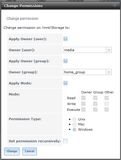

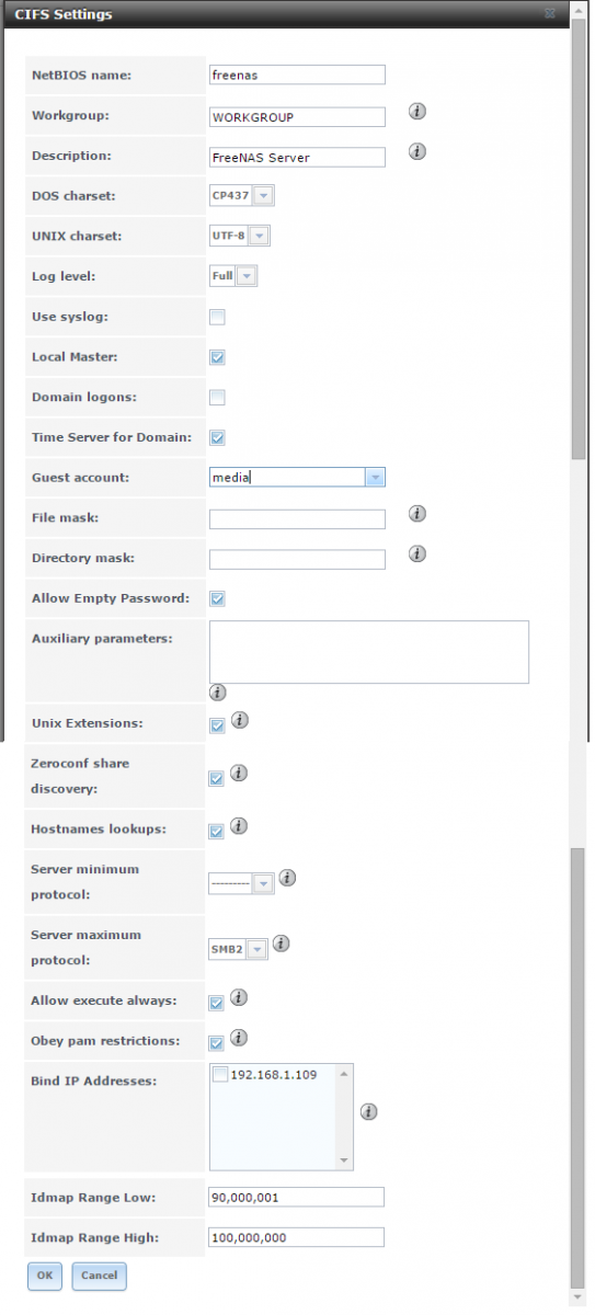

Here are the settings. Let me know if there is a way to get this directly from a settings file in FreeBSD if that is easier to see if something is not set correctly.
CIFS Settings:
Volume permissions:
User info.
SweetAndLow
Sweet'NASty
Nov 6, 2013
6,421

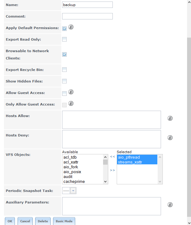

How about the share permissions? And you are using the media user with the correct password to login right?
Another thing to do is not share the top level dataset. This will cause issues in the future.
NoTalent
Jun 24, 2013
28
Share permissions: share-permissions.PNG

I changed the "Server Maximum Protocol" to type to SMB3_00 without any difference. I checked the SMB type and it changed from 2 to 3.
Default CIFS settings
PS C:\Windows\system32> Get-SmbConnection
ServerName          ShareName           UserName            Credential          Dialect             NumOpens
192.168.1.109       backup              Loft-PC\name        LOFT-PC\media       2.10                1
After changing to SMB3_00
192.168.1.109       backup              Loft-PC\name        LOFT-PC\media       3.00                1
192.168.1.109       IPC$                Loft-PC\name        LOFT-PC\media       3.00                0
