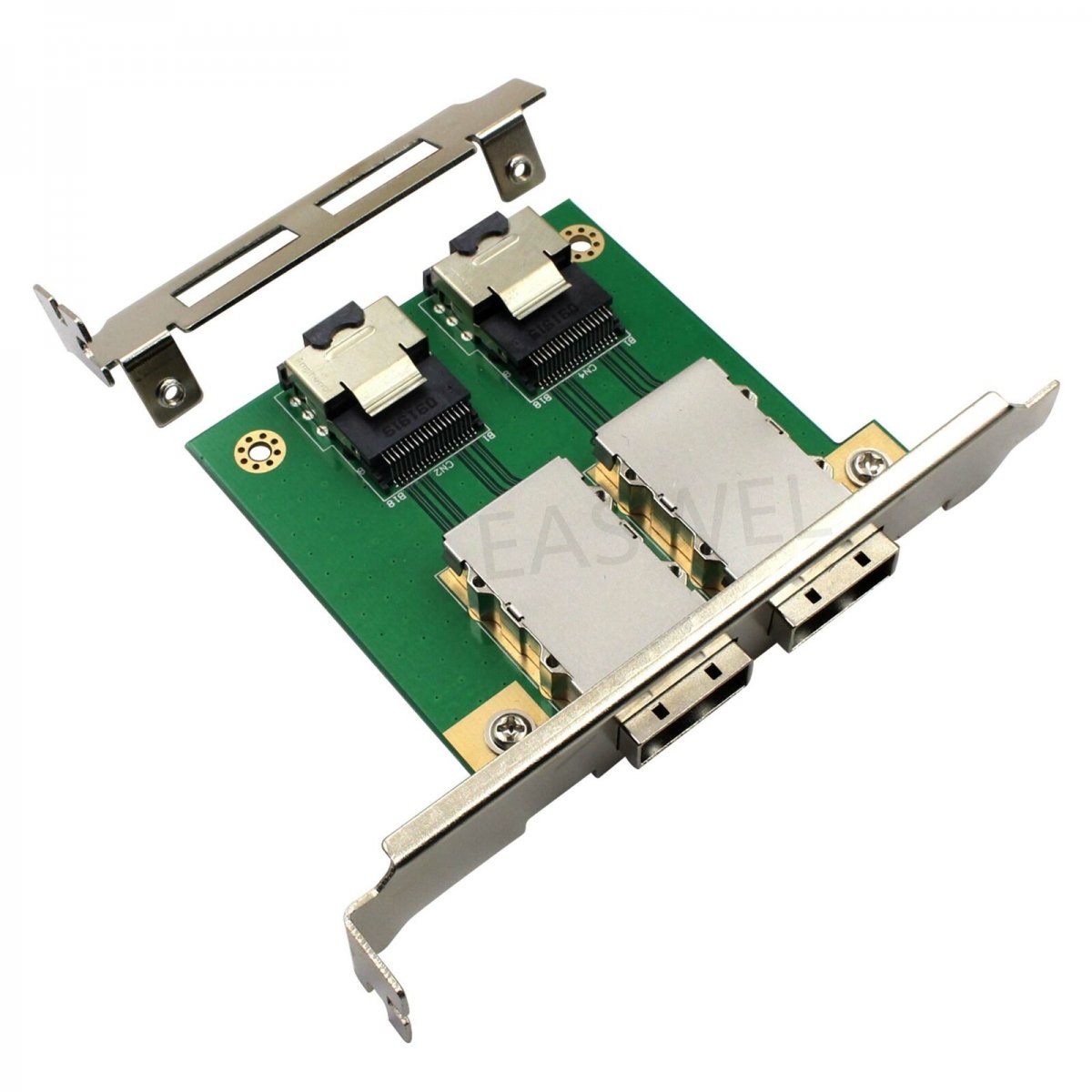

I have a ~12 year old mid-tower case that I would like to repurpose as a DIY JBOD enclosure to accommodate 8x more SATA spinners. I plan on putting a 9207-8e in the z840 and found this little doohicky in my interwebs searches that I would love to use in the enclosure:
Ebay link to card shown below
I plan on using SFF-8087 breakout cables to the 8x drives in the enclosure.
Can you all help me make sure I am using the proper SFF-8088 cables between the 9207-8e and the card pictured above, and, the proper SFF-8087 breakouts from that card to the 8x SATA drives? I seem to remember something about forward and reverse but it has been so long I don't want to buy the wrong thing.
Also, re: that card above...do you think I will run into any issues with it not supporting 8 separate lanes? Is there a better (budget) solution I should be looking at? If there is a more widely accepted 'brand' name of a card similar to the above, can you share?
