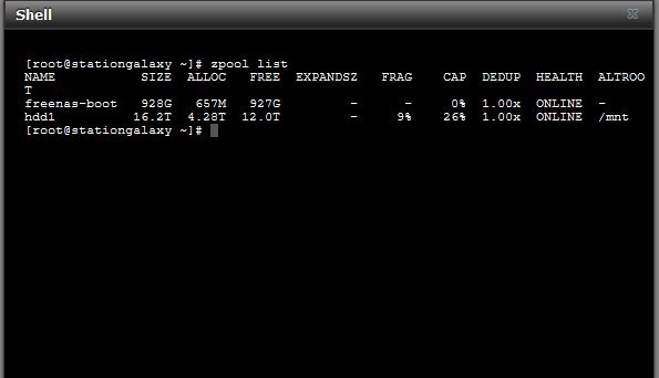

Does 'zpool list' or 'zfs list -o space' show reasonable sizes that indicate your data is still there?

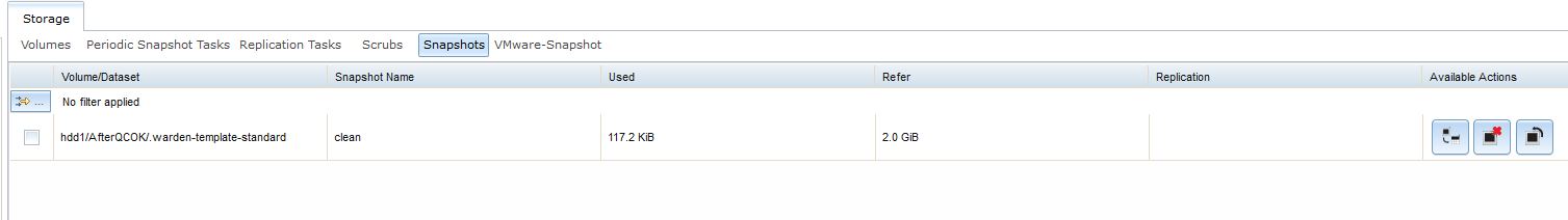

Were you running periodic snapshots? In that case, your data may still be there in the last snapshot before you did the install.
This is my snapshot but I never run it before.

It's look like my data still there but I do not know how to get it back.
Do you have any idea? Please advise.
garm
Aug 19, 2017
1,556
according to the screenshot there is 4 TiB of data on the pool, so there are snapshots of the data or two datasets sharing the same mountpoint

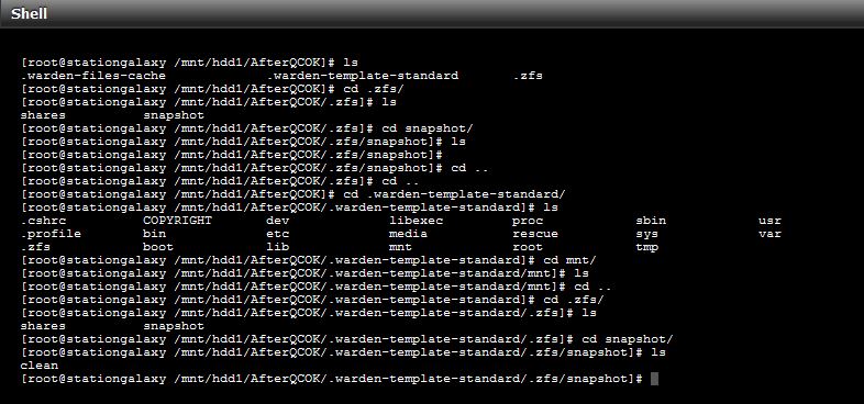

Please find picture.
I have not much knowledge in FreeNAS. Any suggestion.

It's completely possible that your snapshot isn't of the dataset that contains your lost data..., but I also see that we shoudl have been one level deeper:
zfs set snapdir=visible hdd1/AfterQCOK/.warden-template-standard
I suggest you go down the road suggested by @fracai
You still haven't shown us a zfs list output.
Also it would be useful to see if you have a look under /mnt/hdd1 to see if you have an empty recycle directory.
Where were the files originally?

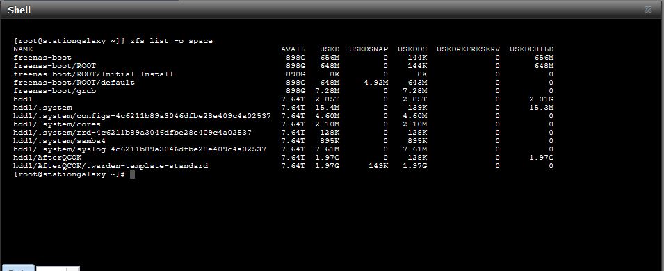

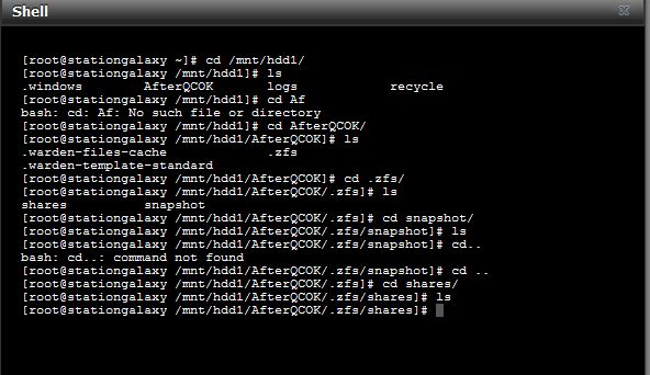

My recycle folder is an empty. zfs list as attached pictures.

You have a directory there called clean, which would be the snapshot you showed, so look around in there a bit.

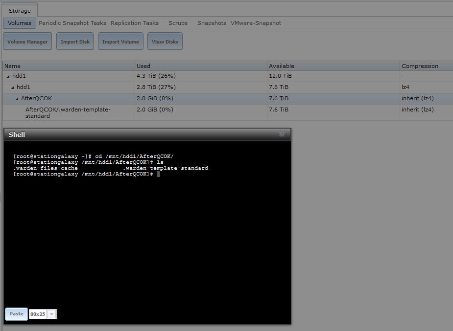

It's still not clear to me where the data was originally, so it's hard to help you to find it, but there's a very clear sign that you have a directory named the same as a dataset somewhere at the root of hdd1, since there's 2.85TB of used space there and including child datasets, the total used is more-or-less the same.

Most likely you have a folder /mnt/hdd1/AfterQCOK/ that contains most of your data (4 TiB) and now you have a dataset mounted on that folder. You need to unmount that dataset and select another location for your jails. To unmount a dataset you do zfs umount hdd1/AfterQCOK. Then I would rename the folder and remount the dataset. Move the jail dataset to a better location and then clean up shares and what ever is used on this system. Also, set up a decent backup.. there are many many ways of loosing data..
9,700
You got it right.
I had an offline conversation with the OP and it was exactly that.
The jail root had been set to that directory and with the first jail install had been mounted over the top of a directory at the /mnt/hdd1 level, hiding the contents.
With the jail removed and the mount forced offline with zfs umount -f hdd1/AfterQCOK the original showed up again.
