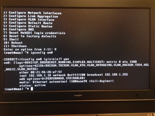

Alec - thank you for your patience.
First I tried the ipconfig using shell - I’ve attached an image for your reference. I tried visiting both 192.168.1.16 and 192.168.1.255 - no luck.
Do I need to add the .255 ip in the options using either option 1 and/or option 4?

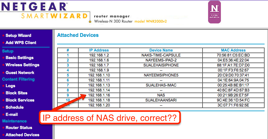

Secondly, I’ve attached an image of my router and it clearly shows the ip address of the “NAS” drive as 192.168.1.16.
What do you think my next steps should be?
Alec Edworthy
Feb 27, 2014
19
The photo of the screen on the NAS suggests that the correctly configured IP address of your NAS is 192.168.1.16 and this is backed up by the screenshot from the router. DO NOT ENTER EITHER 192.168.1.16 OR 192.168.1.255 AS THE DEFAULT ROUTE IN ITEM 4 THAT NEEDS TO BE THE IP ADDRESS OF THE ROUTER, PROBABLY 192.168.1.1 IN YOUR CASE What happens when you try to go to https://192.168.1.16/ in your web browser? If it does not work then find out the IP address of your laptop or PC or whatever you're trying to access the FreeNAS from and then type the following at the command prompt on the FreeNAS,
