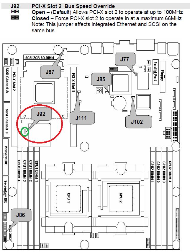

I was able to fix the mystery of the PCI Extended slots not working when both occupied by a simple bus speed override. One stupid jumper that kept my NAS on ice for a few months. So looks like i proved you wrong cyberjock on needing lots more money to throw at the project than what i was able to afford and will not have to look elsewhere for a NAS solution, besides feels good to recycle and use stuff that will work. I hope that the solution found can be used in the future for anyone that runs into the same problem when trying to use both PCI-E are occupied and are searching for the fix. Just put a jumper on J92 on The Tyan S2881 board and should work. I attached a picture of the diagram for use by whoever whenever.
