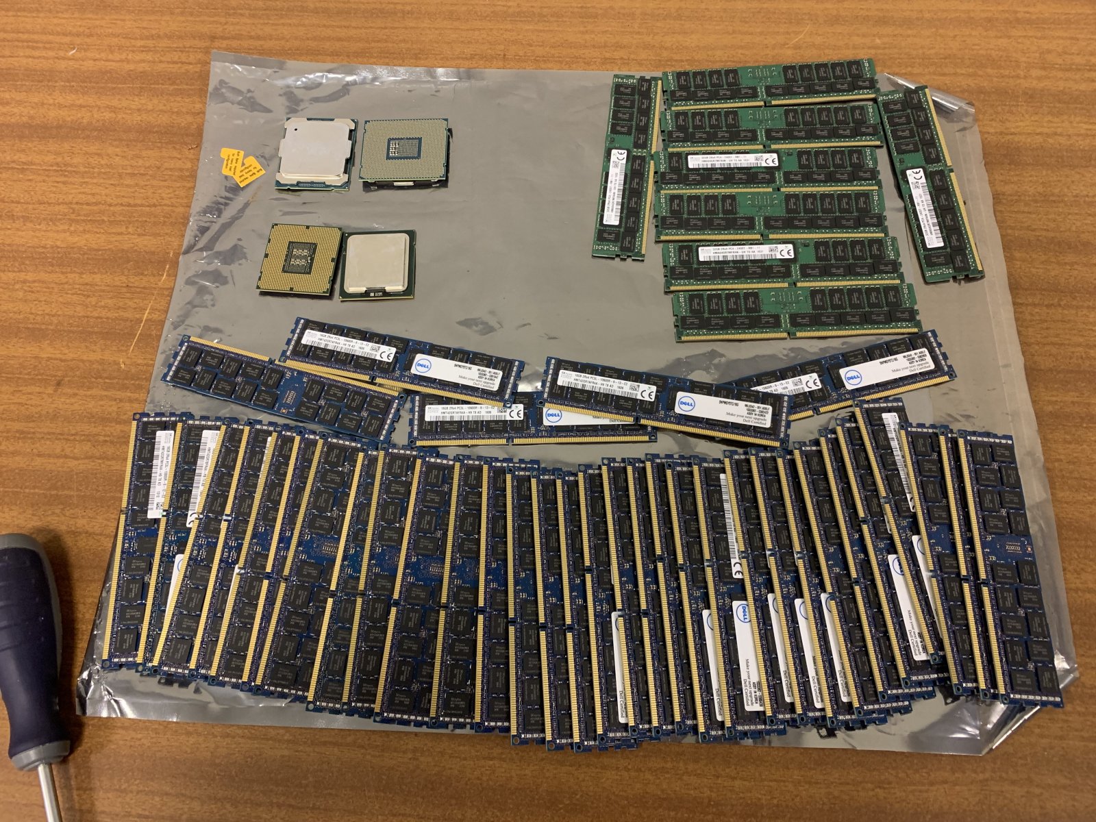

At the time I had no plans, so when they said 'fill your boots' I grabbed what i felt i might be able to make use of from a handful of the blades. They had been brought over time as our capacity needs grew, which is why there is such an age spread. But already I was thinking 'why by a NAS, I might as well build one, I now have most the parts, I knew what FreeNas was, I'd seen plenty of videos about it, but had always dismissed it as buying heaps of ram was the biggest off putting cost for me... But with these parts, it suddenly seemed ludicrous not to make the most of it.

Just a small selection of the stuff I saved from the skip.

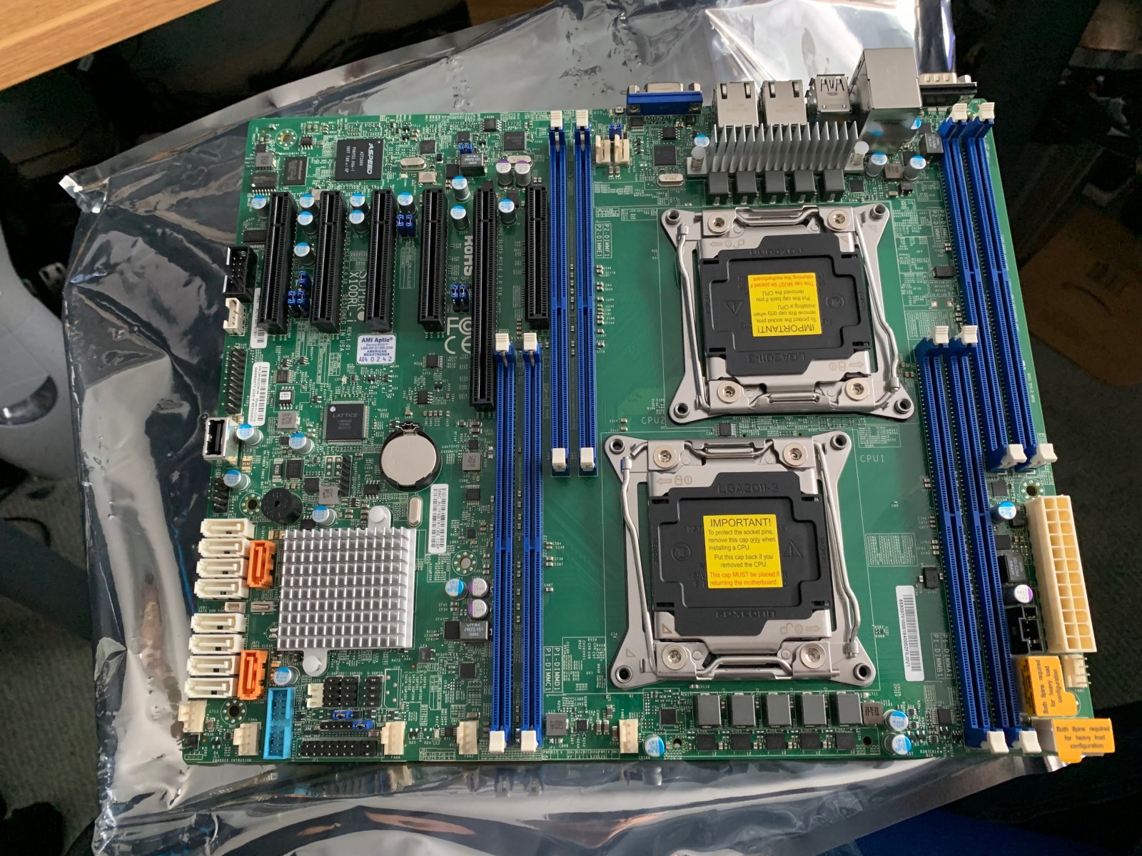

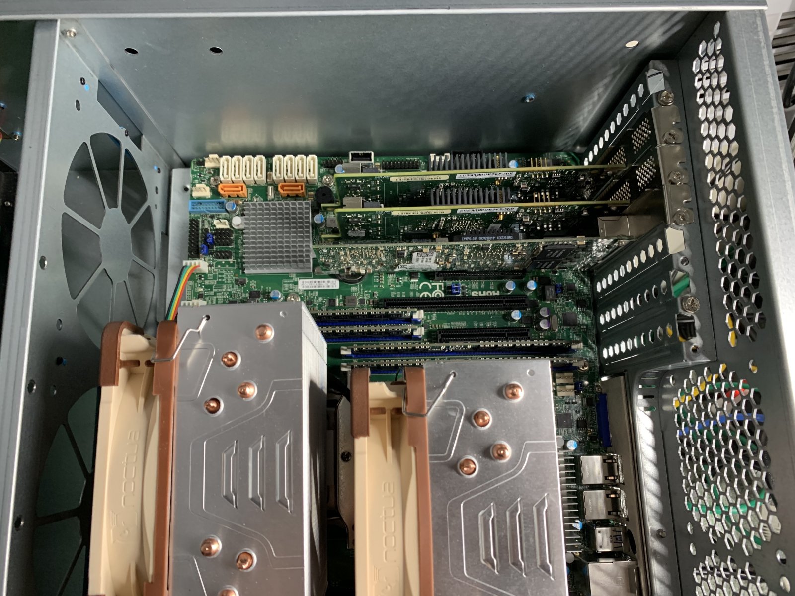

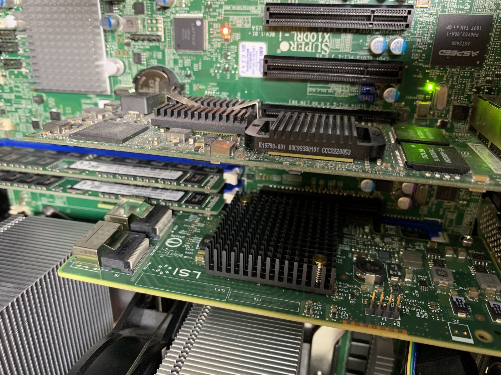

The motherboard I settled on... using that right hand PCIe slot is going to be a challenge!!
I tried test fitting the LSI card... no chance...

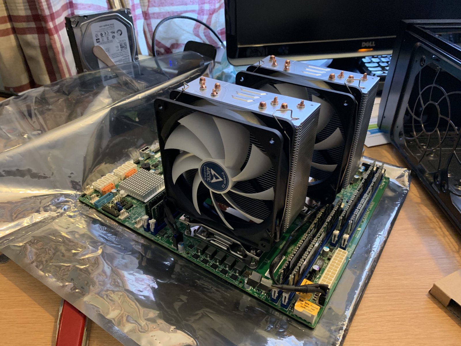

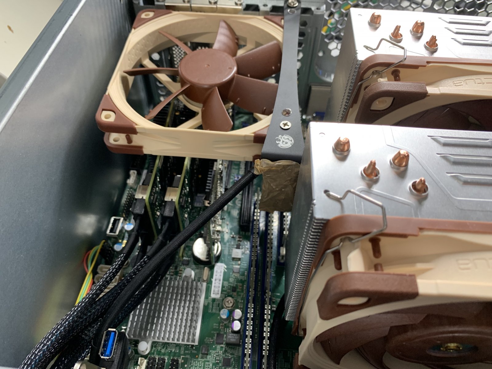

Coolers on... hard to find coolers that would clear one another as the sockets are SO close...

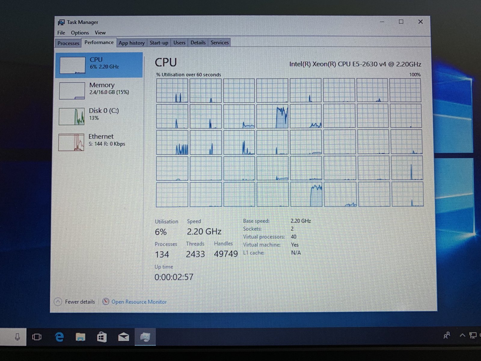

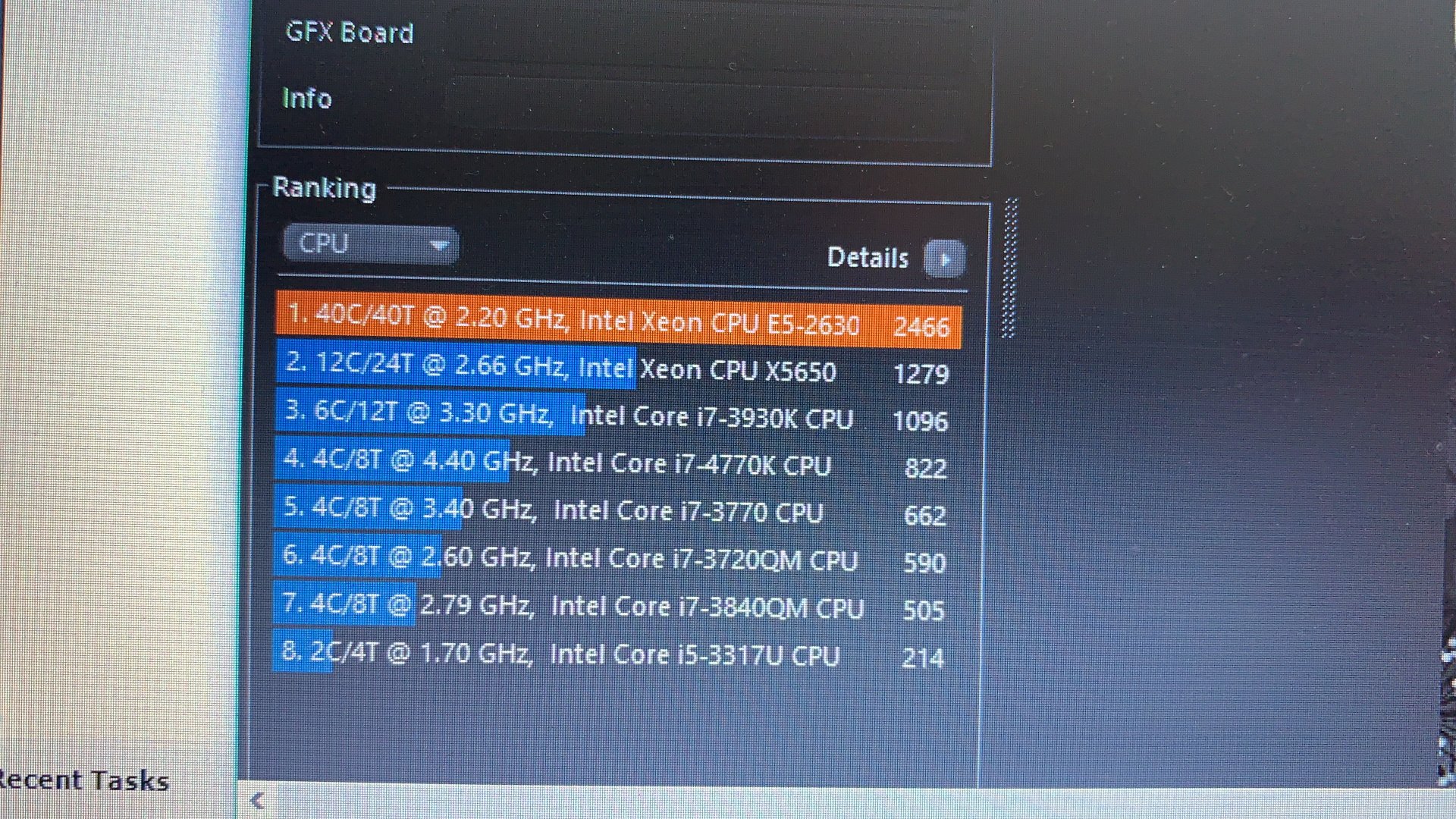

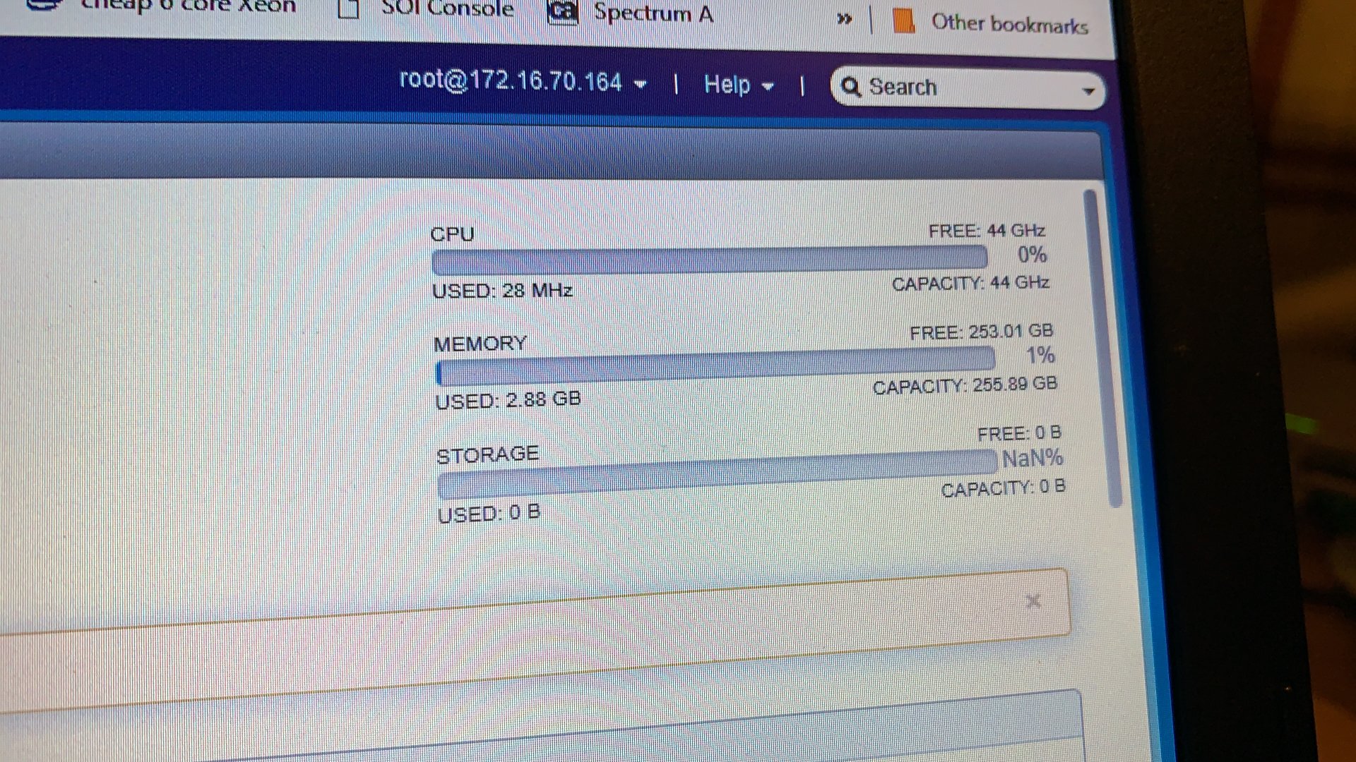

Once fired up, I threw together a VM just to run Cinebench for the lol's! Impressive numbers for "old" hardware!

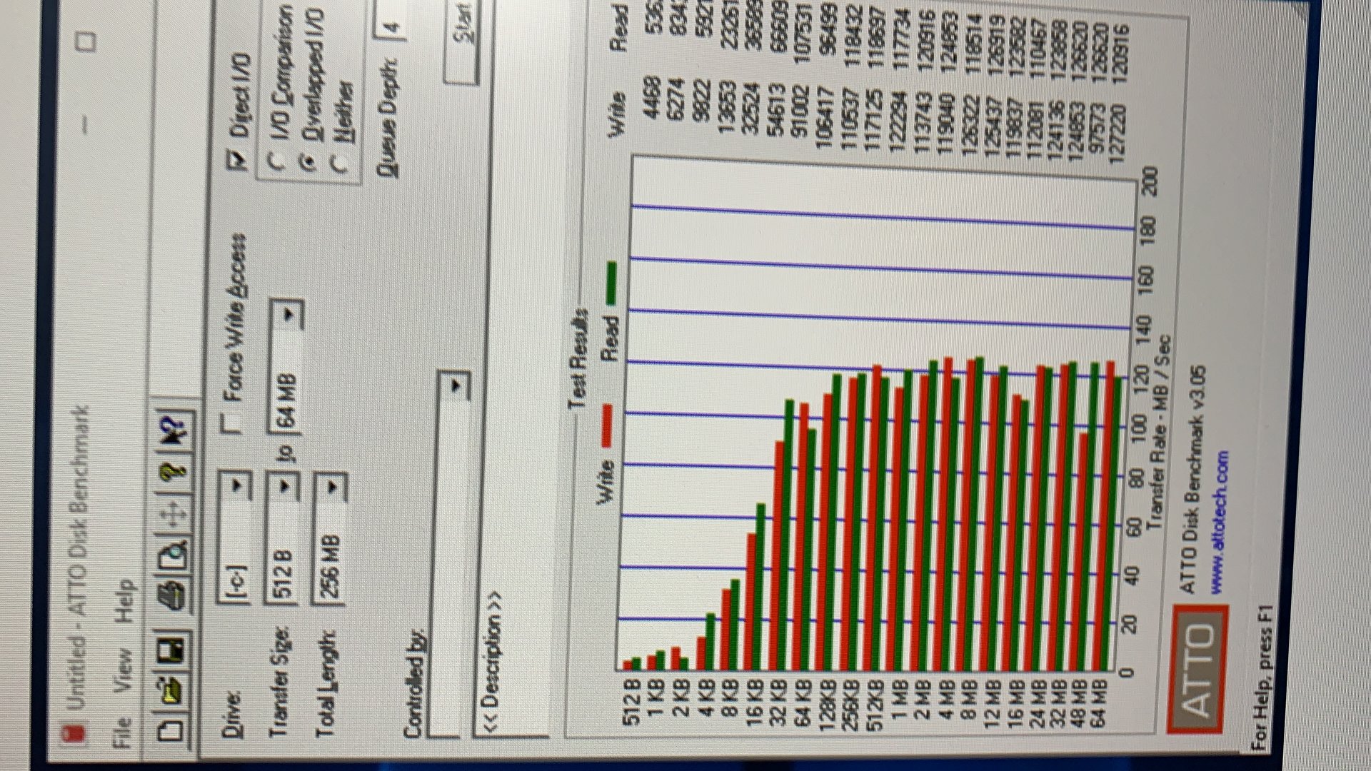

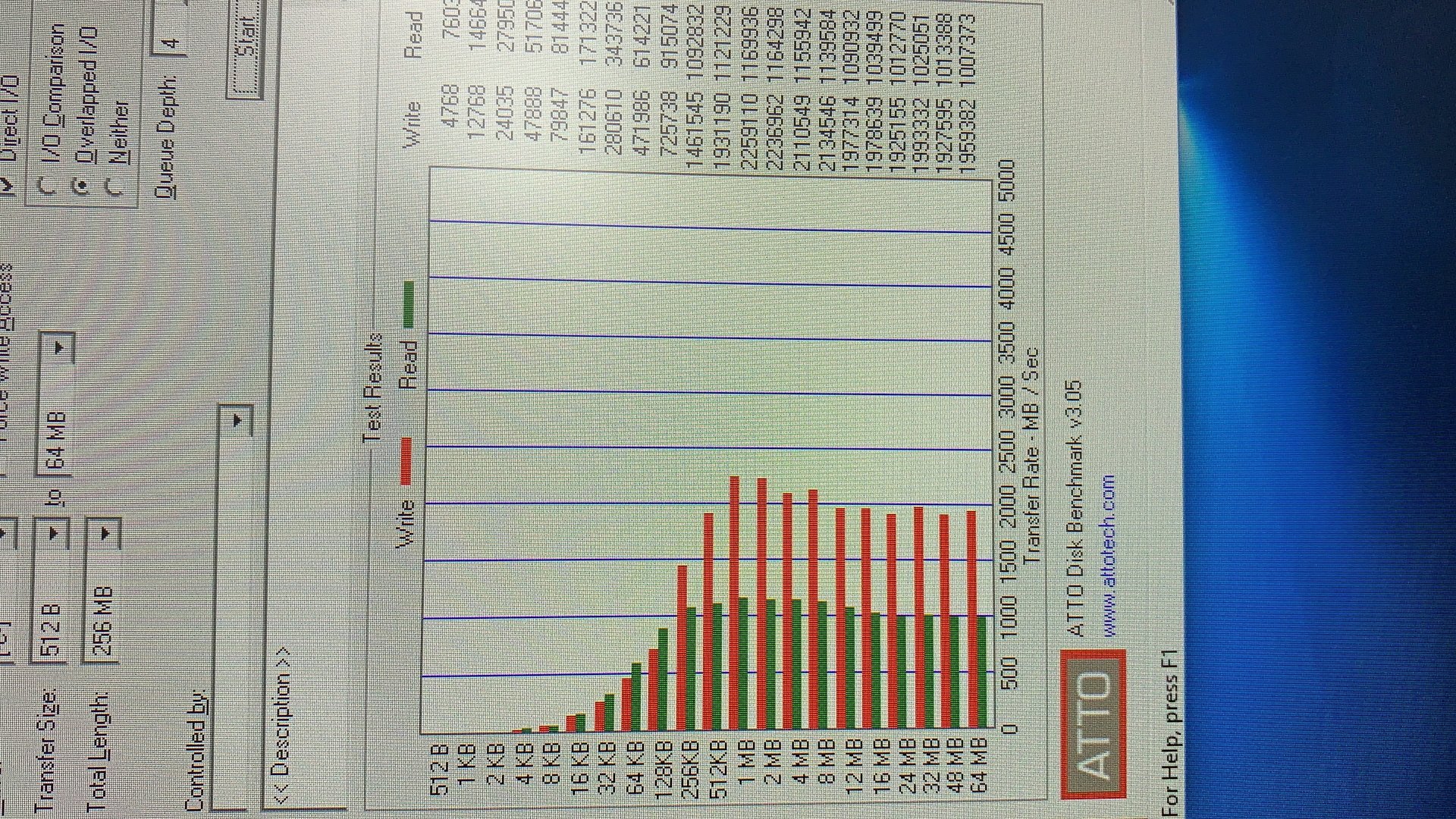

This is what really impressed me... this is a disk benchmark from a VM running on my old i5 server with the C Drive on a iSCSI volume on my Synology NAS over gigabit... (no idea why it keeps loading in sideways)...
but now, as the iSCSI server and VMs are on the same internal vSwitch, and traffic never leaves the box.. these are the new numbers... Mind... BLOWN.... (again, not sure why its loading sideways)
Confused why the writes are faster than the reads?.... Something else to read up on :)

Yeah new, but i needed an ATX board which ruled out EATX, CEB and all the other larger boards, the only board i could find that would fit was still so new that I couldn't find it used, so I ended up biting the bullet.
For my backup server through, this is what I'm struggling with... a single socket board (new) is about £270. Older sockets (for the other two types of CPUs i have) are almost as much!! So plan B is an older board and CPU combo, but I'm planning to host it at a friends, so IPMI is a must, so again... options very quickly start to dwindle.. :(

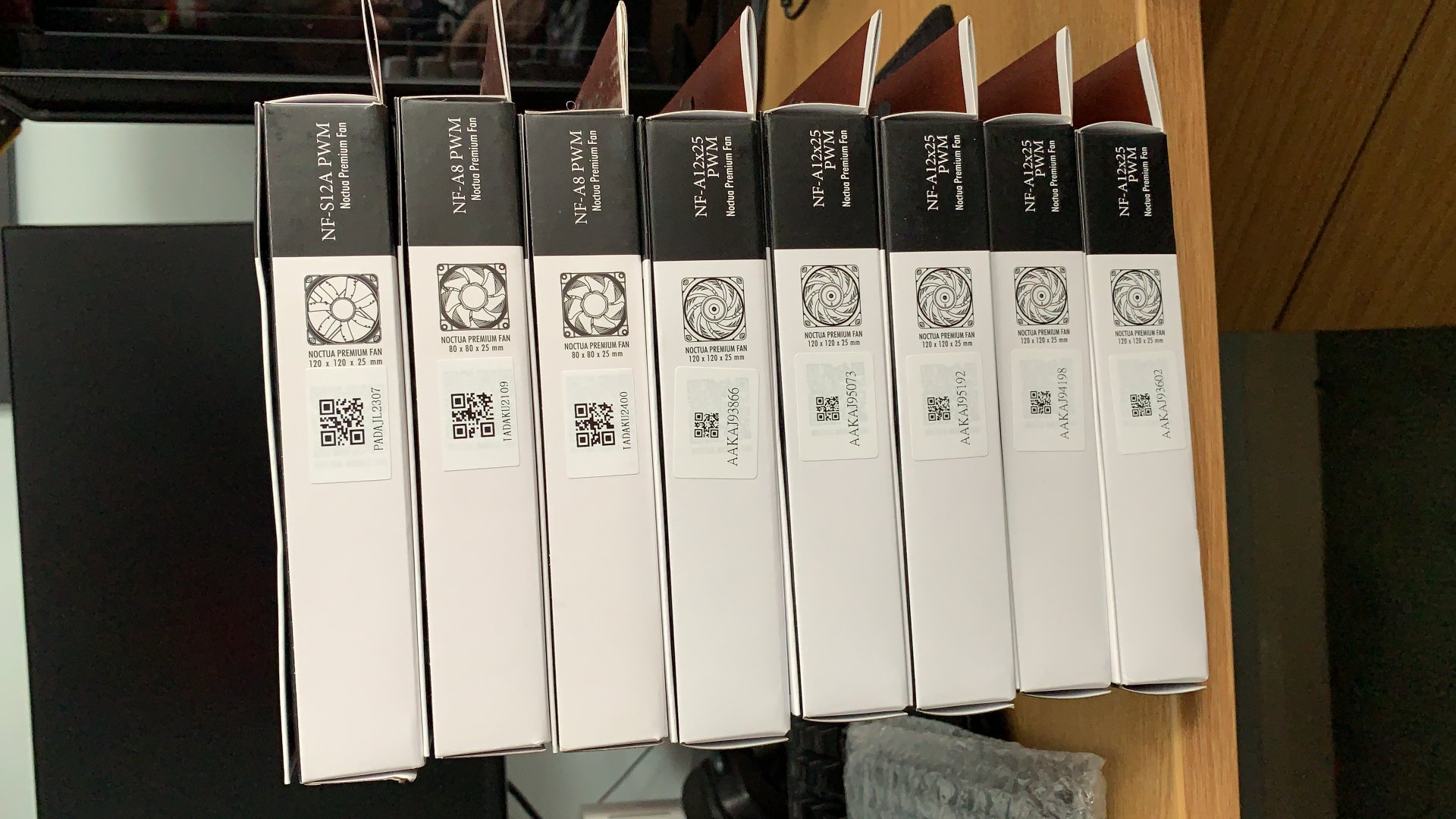

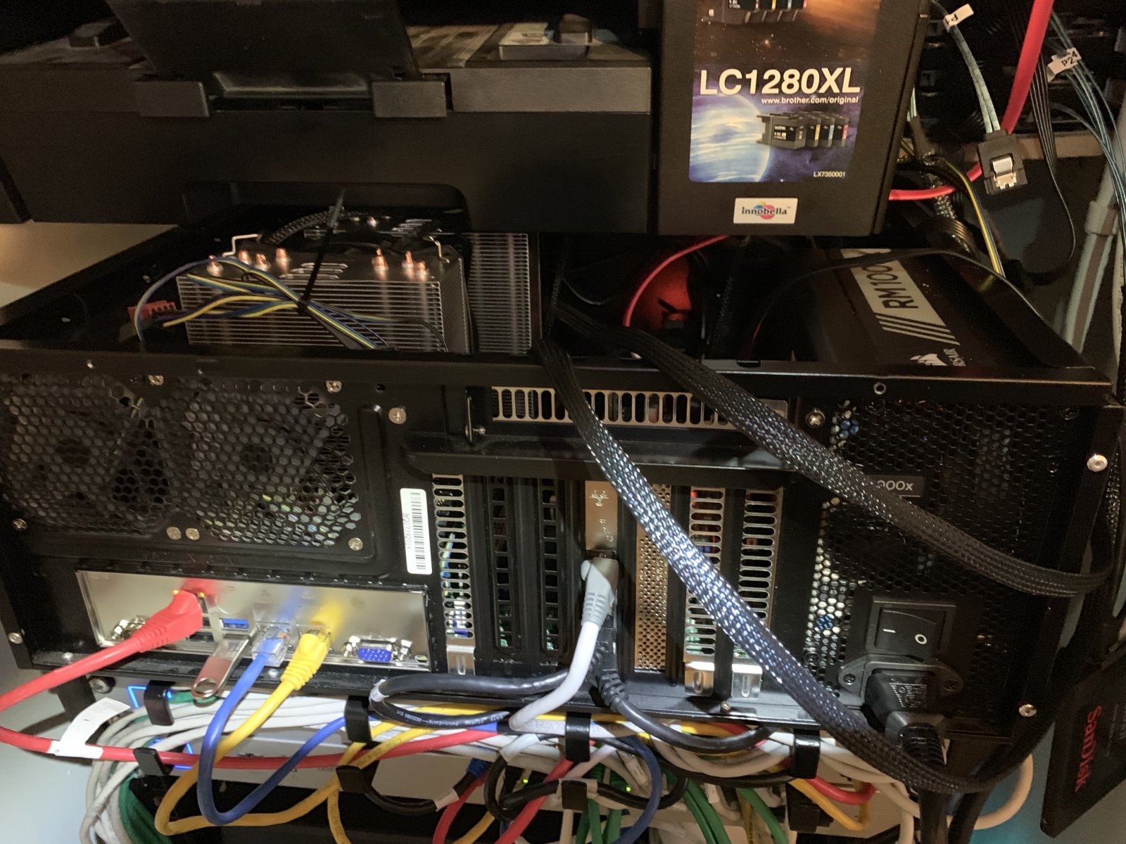

Server chassis arrives tomorrow... mini sas cables and fans arrived today... £172 worth of fans!!!! #donttellmywife
Saturdays going to be fun!!

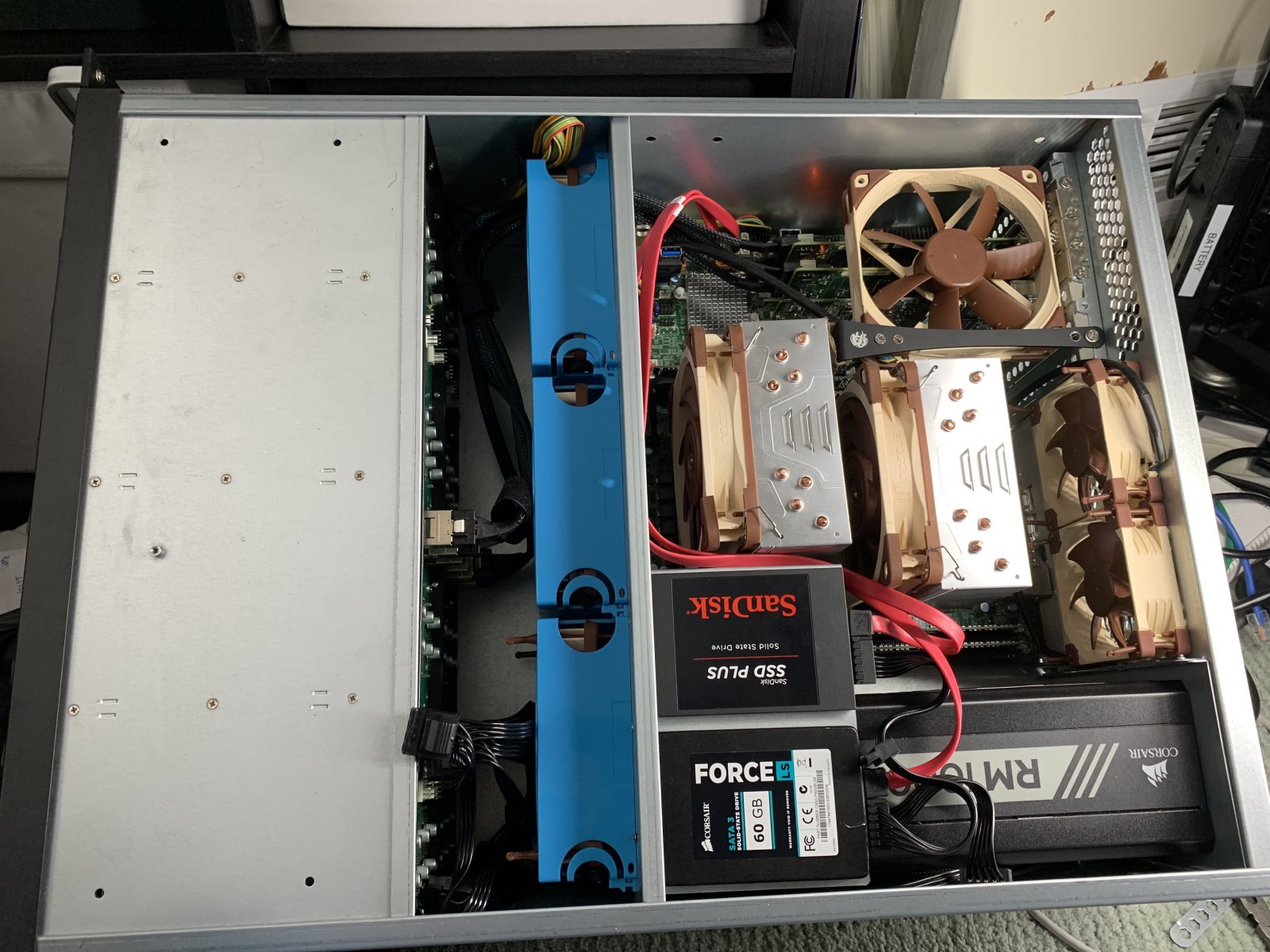

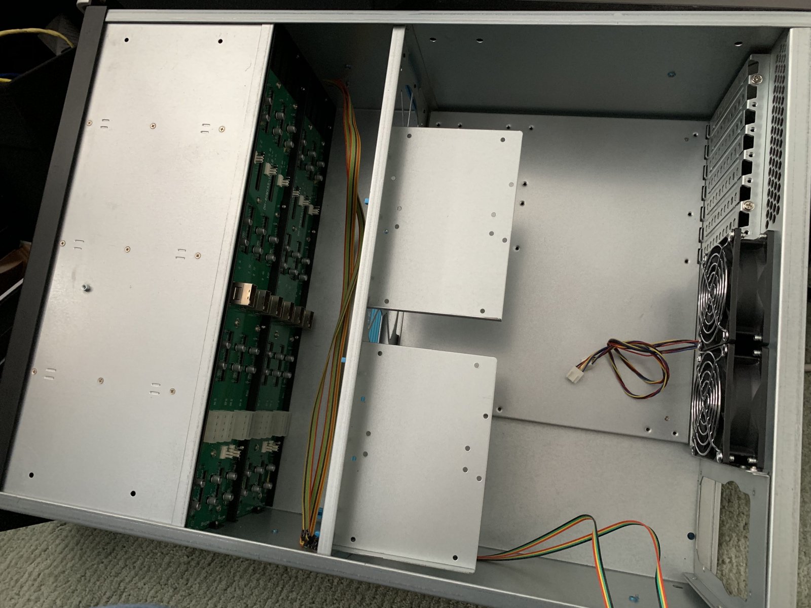

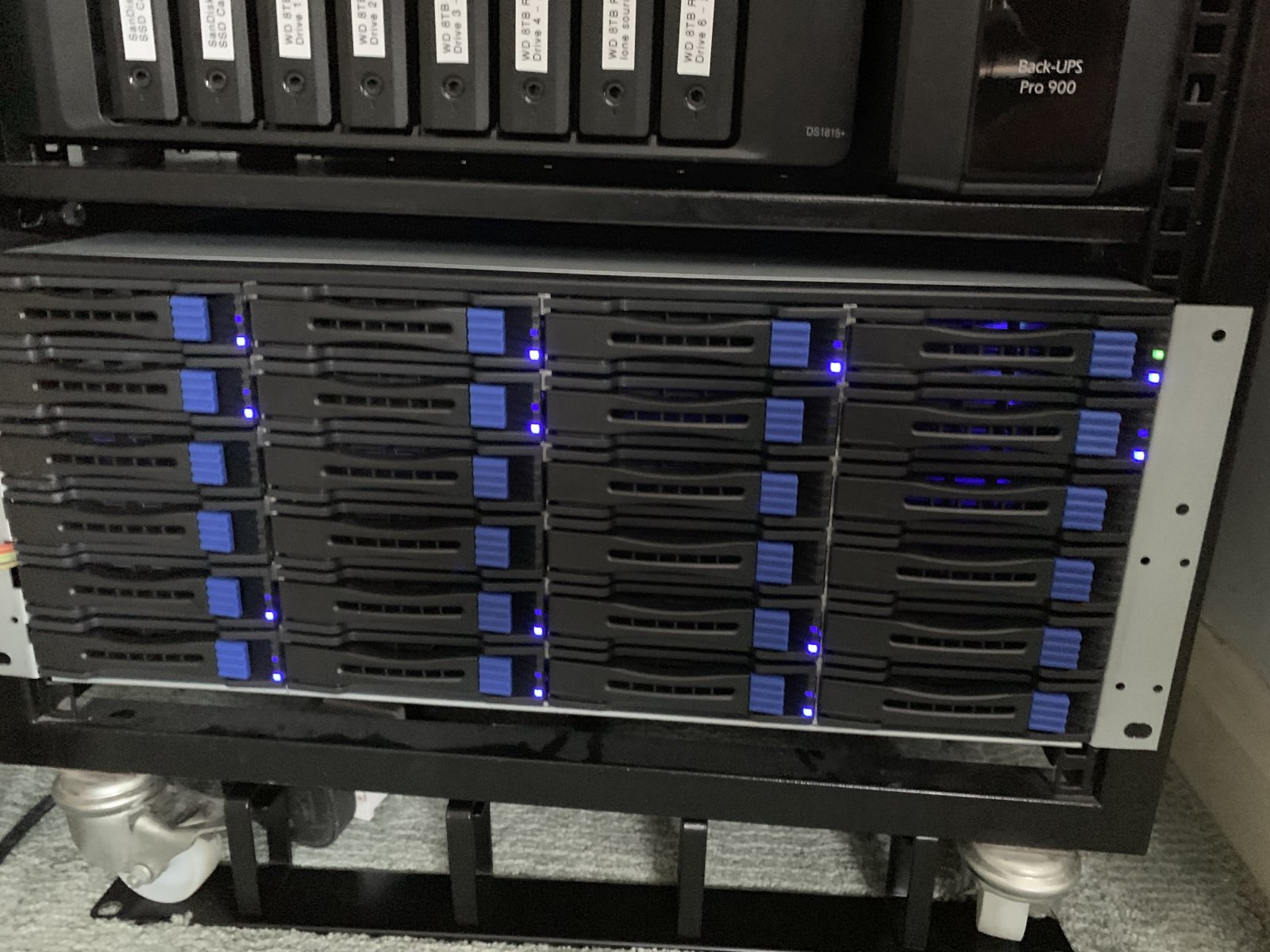

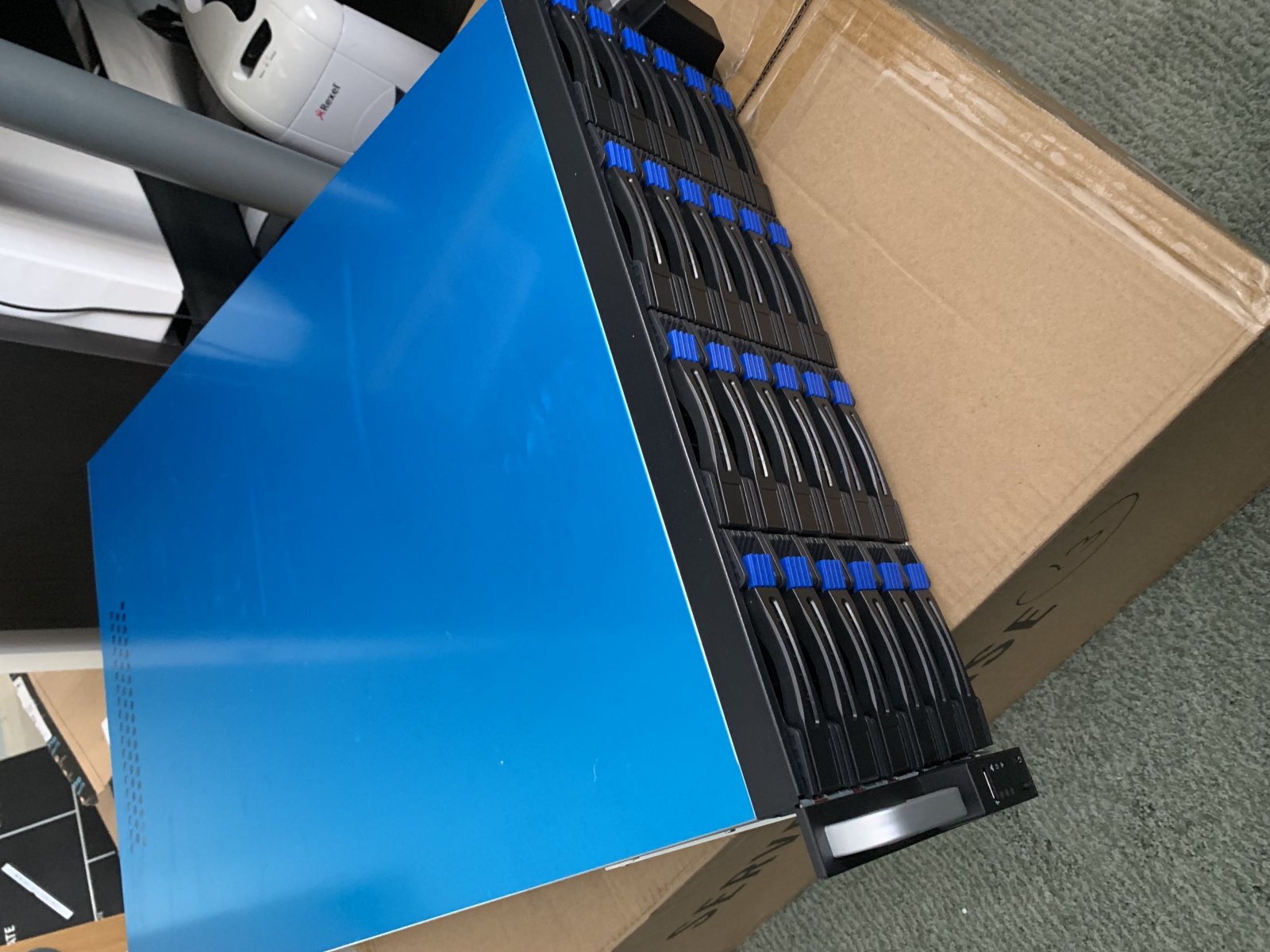

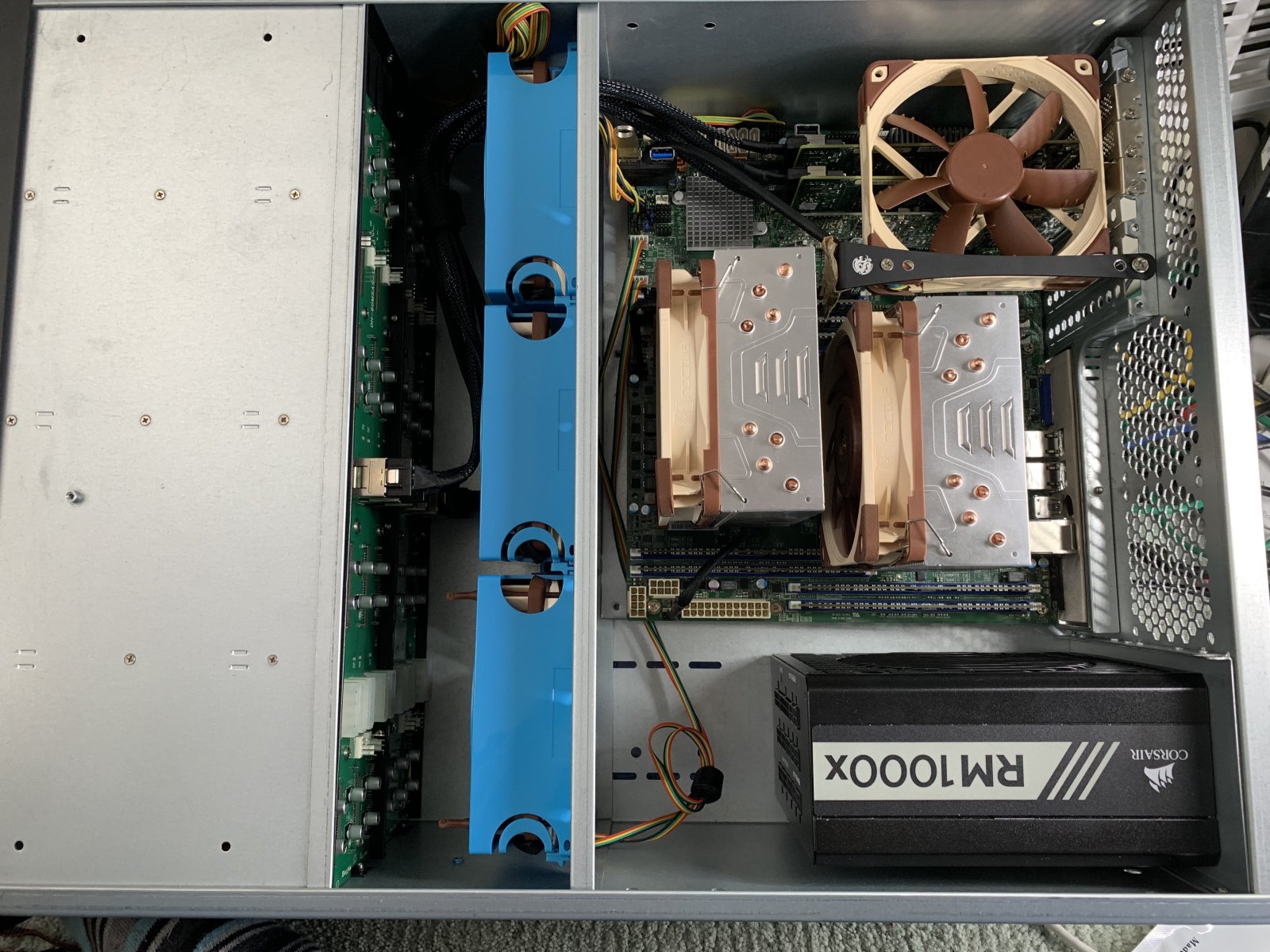

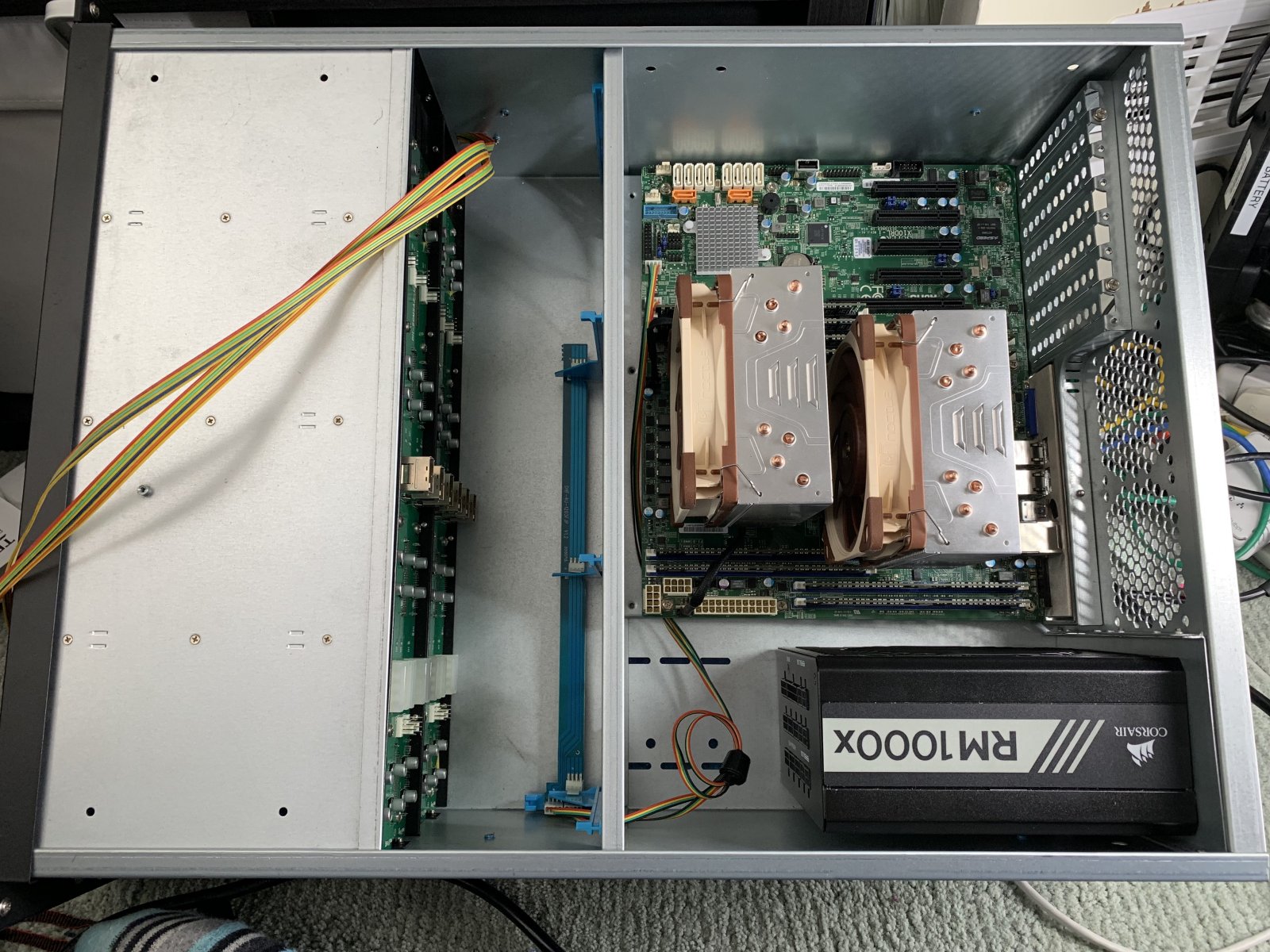

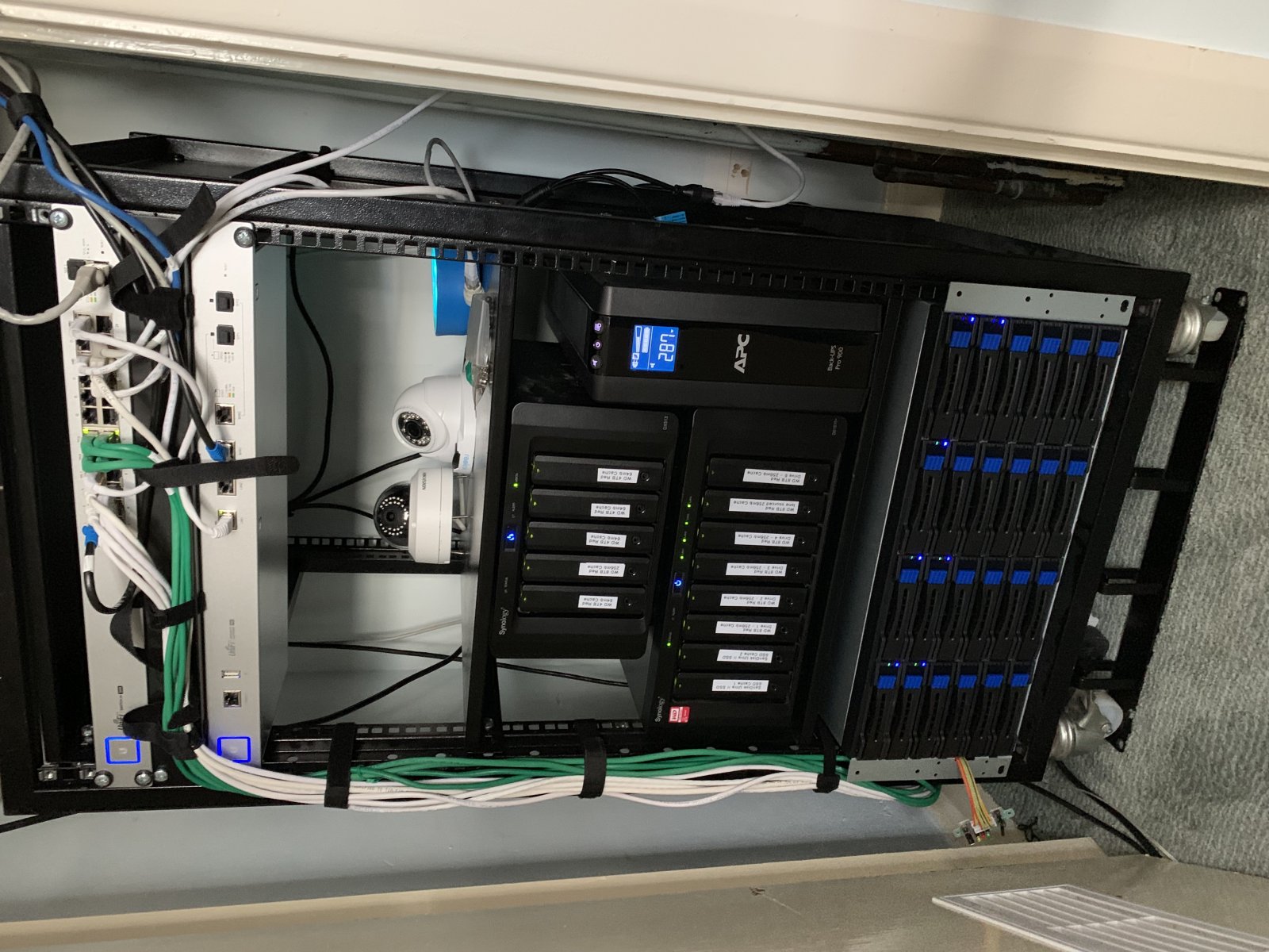

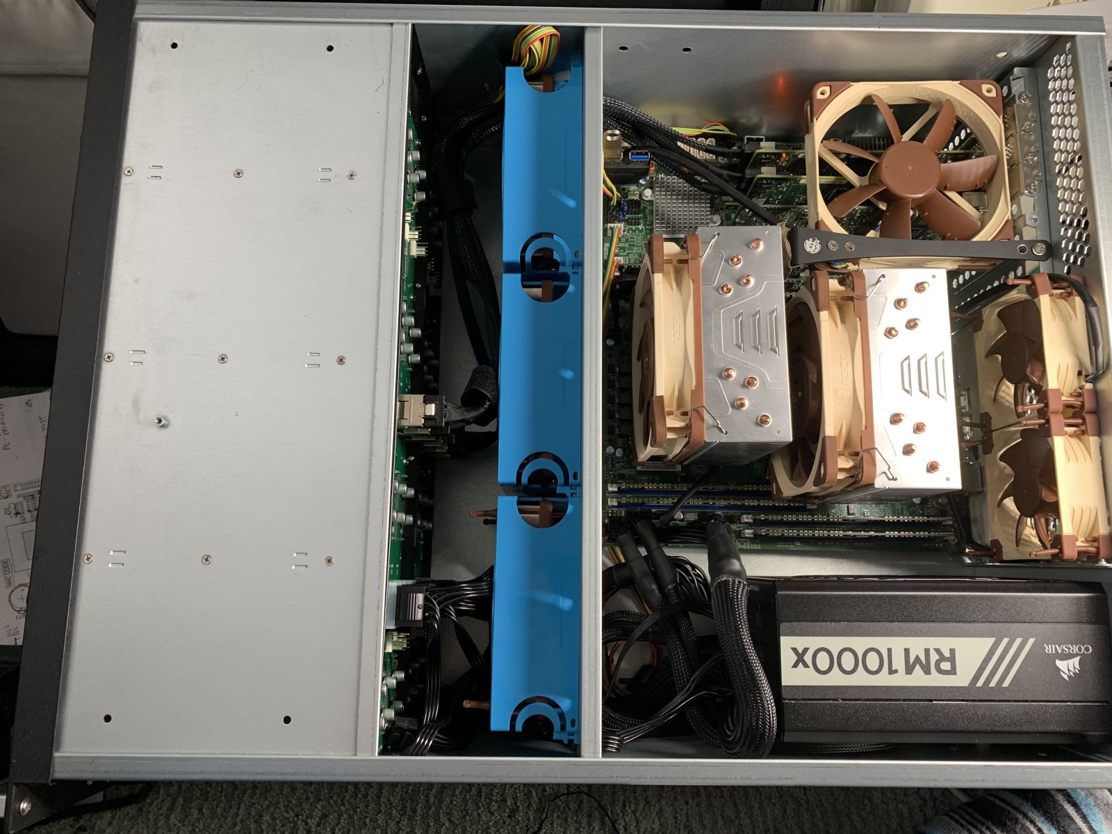

So the parts finally arrived, bit of issue with the comany that supplied the case, but thats boring so won't bore you with that... but here it is! Transplanted my build from my HTPC case, installed all the new fans, and installed the first batch of additional drives (6x4Tb Reds)..
Now starts the process of moving data off my 6x8Tb array in my Synology Nas to other locations to allow me to transplant the drives into this chassis. The question is have is that my Synology NAS has 2x 512Gb Samsun 860Pro's which are used as a cache. I already have a pair of sacrificial 240Gb desktop SanDisk SSDs configured as L2ARC, but am I right in thinking that for use as a home storage server, using as a SLOG would be total overkill? If so, whats the best way to make use of these? Thoughts?
In the mean time, heres some pretty pictures :)
