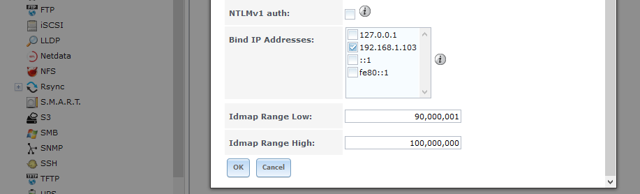

You should be able to do that, but you might have the share bound to the IP address of the first interface only.
Take a look at your SMB service configuration:
