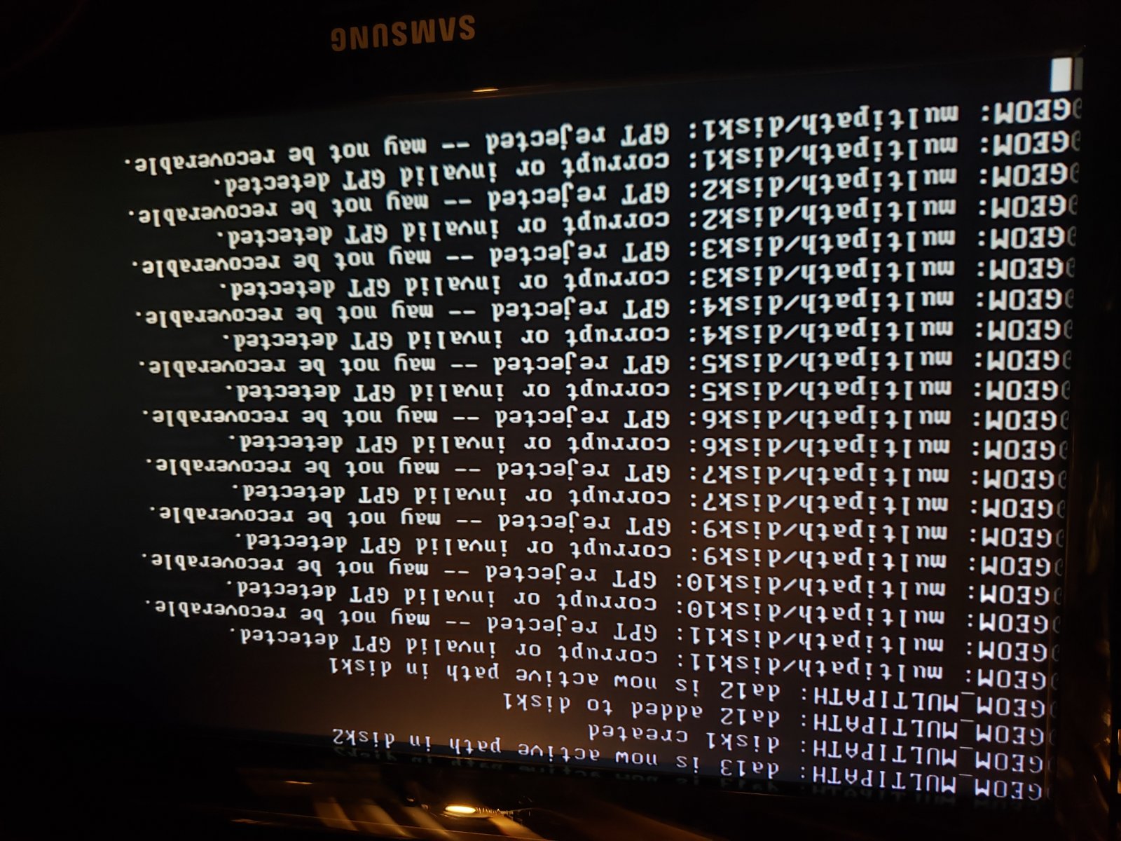

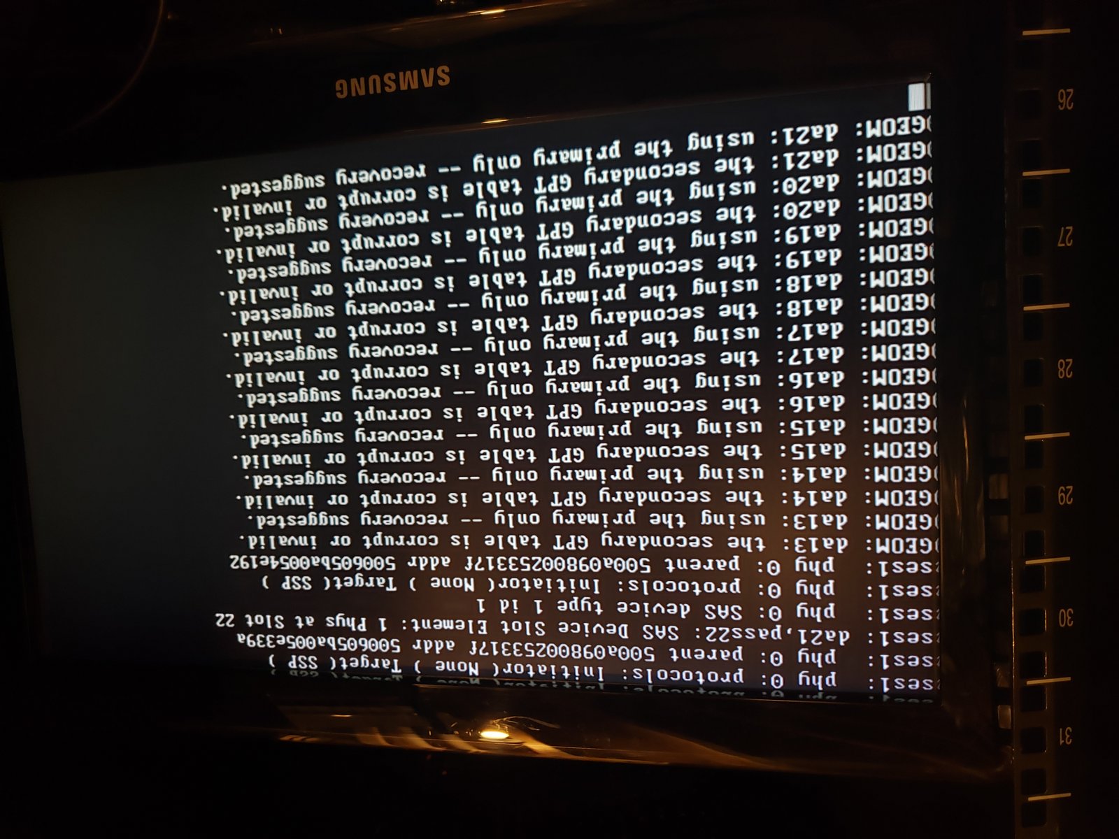

Still in need of some assistance here. After further investigation, I determined that something was wrong with my disk shelf (only random disk lights were on, the shelf ID was blank, there was very sporadic information about the disks being reported to freenas)
So I installed all the disks in a new shelf. During bootup I get the attached errors.
Multipath errors - corrupt or invalid GPT / GPT rejected
also secondary GPT table is corrupt or invalid, using the primary only.
In addition to the bad disk shelf, I had some odd behavior with my internal HBA, so decided to move the internal disks into the external shelf. Those disks show up fine - and are the only disk group that is listed when I do a zpool import. groups 1 and 2 do not show up, but the disks do show up when I do a camcontrol devlist all.

Hi All,
When I've moved shelves before I did not have any issue with the cables being connected differently, so does where the cables plugin to the shelf matter?
