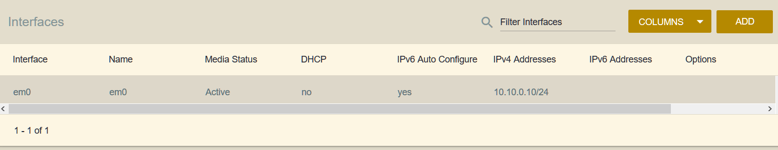

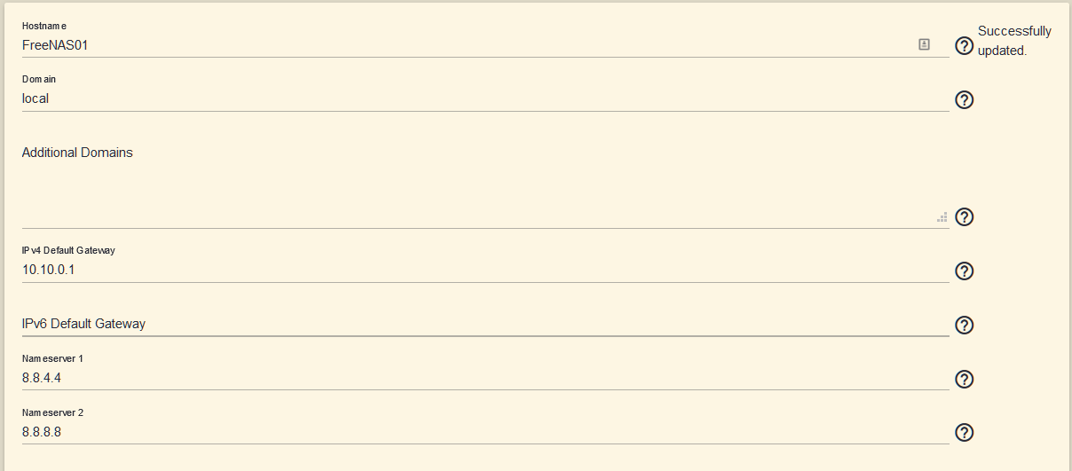

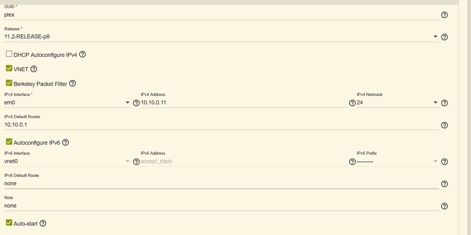

Happy to help. Yes, if I hadn't seen your last update I would have told you to clear ipv6 since what you were doing with it wouldn't work, but you figured it out.
