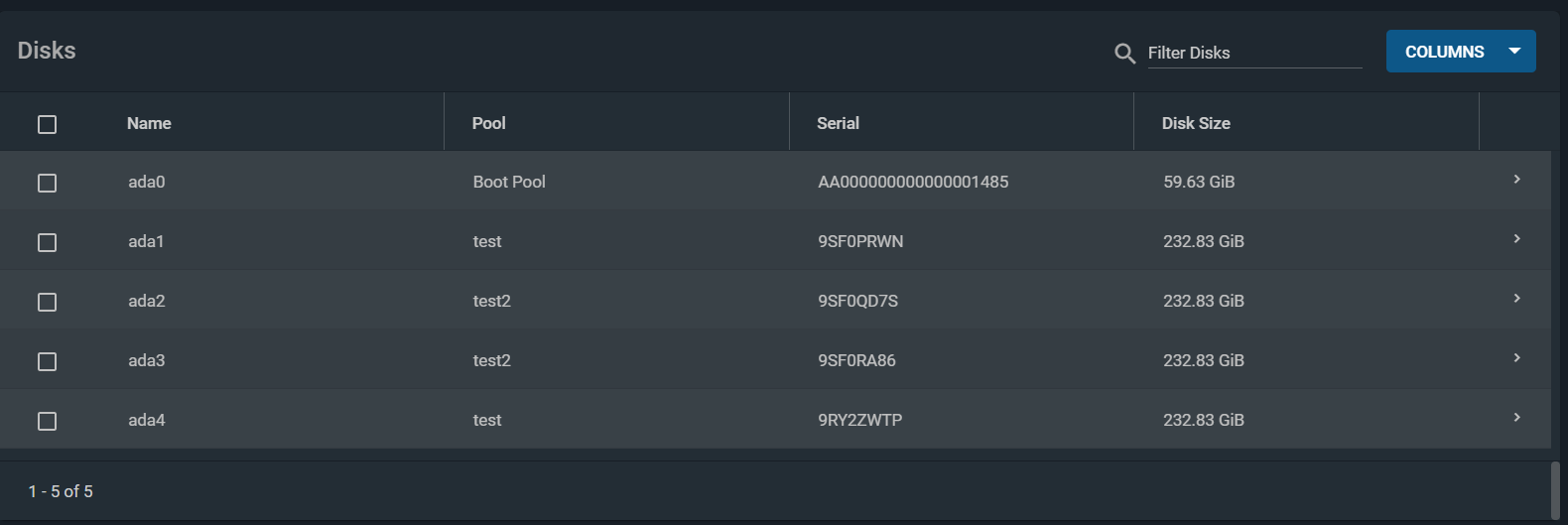

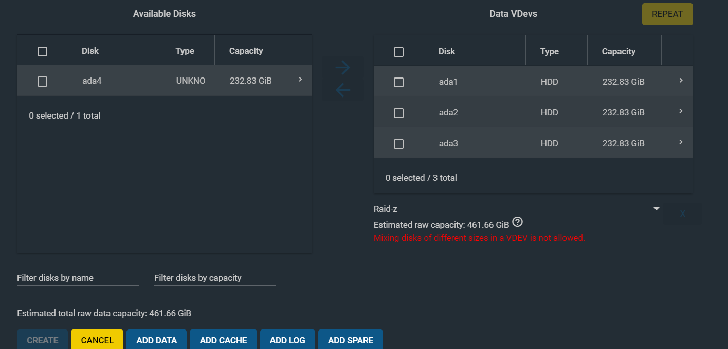

Testing with 11.3 on a Supermicro X10SBA (J1900) with 8GB of ram.
I have 4 x 250GB Seagate drives installed, 3 are the same model. I can get two of the drives to allow me to create a pool if I use the 'suggest layout' option but if I manually try to add the drives (again, 3 with the same model number and size) I get the error below.
All three drives are:
Rotation Rate: 7200

Thanks. I can only make a vdev using disk 1 and 4 or 2 and 3, but not any other combination.
Any other combination gives me the 'Mixing disks of different sizes in a VDEV is not allowed'.

I just ran into this same issue with 6x WD Red 6TB drives. Found this other thread where someone was able to do it in 11.2-U7.
I made a new usb with that build. Now it's just a warning instead of a blocking error: Mixing disks of different sizes in a VDEV is not recommended.
So it sounds like the bug already exists pre-11.3, it's just that now it's an error in 11.3.

11.2-U7 had the legacy UI so we could override the restriction there, iX in their attempt to protect users from themselves removed that ability with the death of the legacy UI in this ticket

Fix is in progress. We're going to make it a bit less strict on the checking, but also provide an override as well, in case somebody really does want to make a mixed size vdev.

I'm a new user to freenas using 11.3-U1
I was having the same problem an hour ago, with 3 identical Sandisk 480GB SSD. However for some odd reason, one of the drive capacity was 447.14GB while the other 2 was 44.13GB
I found my solution here: https://www.ixsystems.com/community/threads/unable-to-import-zfs-volume-into-freenas-11.54871/
What I did:
1) create pool using command line form webui shell
# zpool create tank raidz ada1 ada2 ada3
2) export the pool
# zpool export tank
3) Import the pool using webui
Storage > Pool > add> import
I've successfully added the pool and was able to add dataset using the webui
hope this helps
