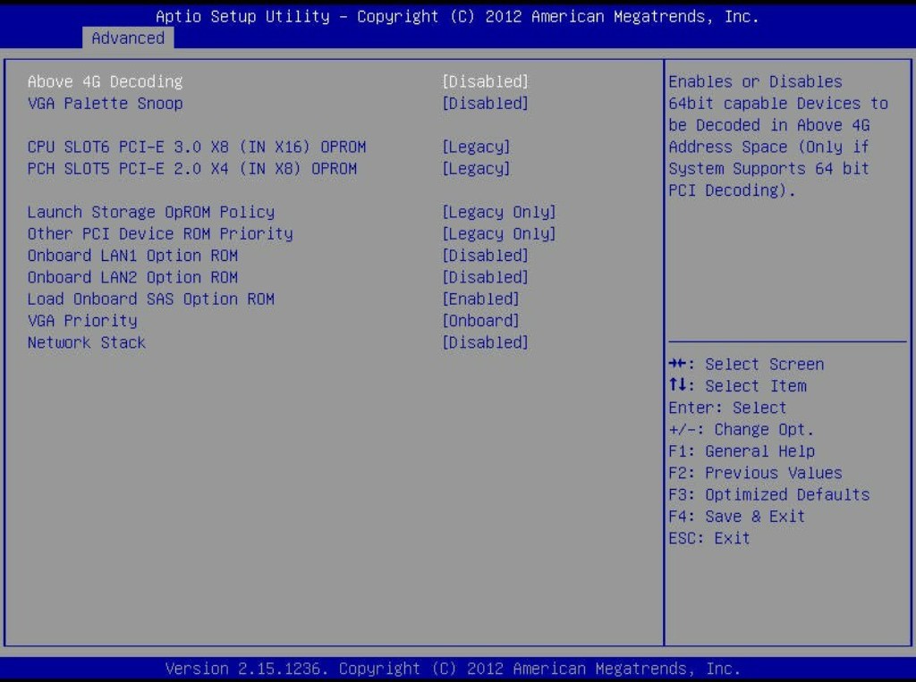

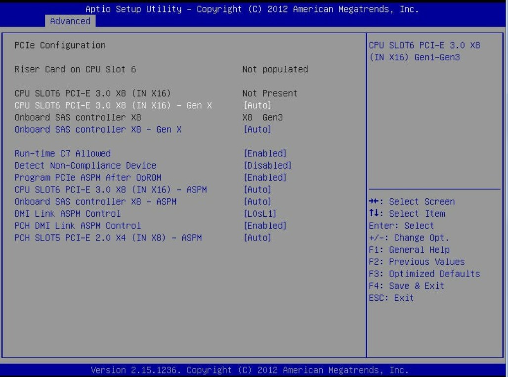

Make sure you haven't inadvertently dorked up the SAS controller settings in the BIOS. Here's how mine looks under Advanced->Chipset Configuration->PCIe Configuration:
Advanced->PCIe/PCI/PnP Configuration:
You might look at Advanced->Boot Feature and see if you need to tweak the 'AddOn ROM Display Mode' to force the LSI setup screen to show up during boot.
