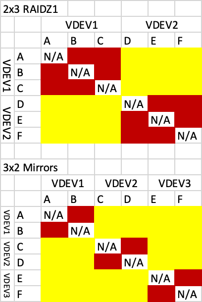

Take the scenario of a 2 disk loss:
2x3 RAIDZ1
A B C + D E F
vs
3x2 Mirrors
A B + C D + E F
If drives A & F are lost...
Both scenarios are still OK, both VDEVs degraded in the first case and 2/3 VDEVs degraded in the second.
Lose drives C & D and in the first scenario, still OK, but in the second, the pool is dead.
Lose B & C, the first scenario you lose the pool, 2 degraded VDEVs in the second.
Actually this is quite easy to play out in a matrix to show it visually
Red is a lost pool, yellow is one or more degraded VDEVs.
As you can see the RAIDZ1 scenario lands you in a lost pool twice as often as the mirrors do.
In all cases, a single lost drive will leave one VDEV with no redundancy. In the RAIDZ scenario, there's around twice the chance that the second failure is in that same VDEV
I'm sure somebody will point out that this doesn't need to be a complete matrix as it double-counts everything, so you can stop reading at the N/A on each row and still come to the same conclusion. (A + B fail is the same as B + A fail... etc.)

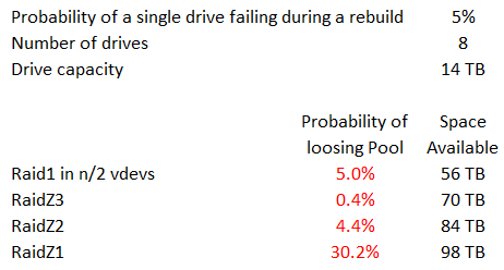

This morning I was looking at other options and I found a thread in another forum (not sure is posting to another forum is allowed) where the person ("John4200") calculated the chance of loosing a pool based on the probability of a single drive failing during a rebuild. He did that for RAID10 (n/2 vdevs in RAID1), RAIDZ1, , RAIDZ2 and , RAIDZ3. The results were quite surprising.
We are now doing 8+1 disks -- 8 disks in the pool with 1 hot spare. All disks are exactly the same model, Toshibas 14TB MG07ACA14TE.
So I plugged his formulas in excel and keeping the pool at 8 disks and assuming a 5% probability of a second drive failing during a rebuilt the numbers came up to the following (the storage figures are not 100% accurate, but I do not know how to calculate them... but they should be directional:
I do not know if 5% is a reasonable figure for a single drive failing during the rebuild, but that is what the guy used.
I attached the spreadsheet where I put his formulas.
So based on the above I think we are going with an 8-disk RAIDZ3 with the 9th disk being a hot spare.
Does that sound right?

Well, it looks like you're very keen to avoid any risk of pool loss... RAIDZ3 is the best option you have for that other than multi-way mirrors (which are very costly).

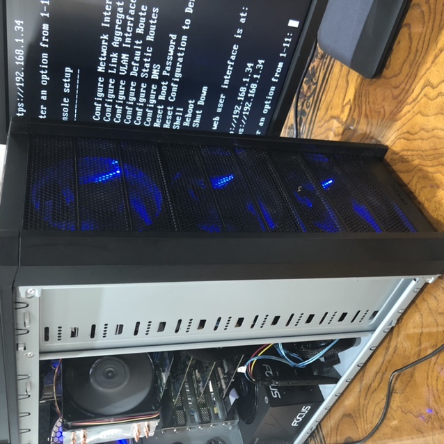

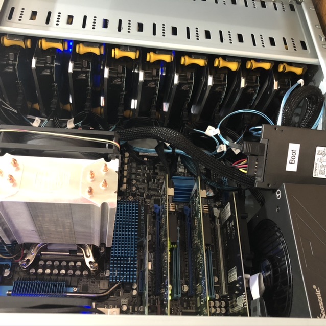

The deed is done. Now moving data back into the new pool.
I was shocked!!! Absolutely shocked!!! That a TB was 10^12 as opposed to 2^40. I thought I was getting 14 * 1024 * 1024 * 1024 * 1024 and they are 12.7 * 1024 * 1024 * 1024 * 1024. That is such a ripoff. Freedom units man... freedom units!!! SI is a ripoff, LOL.
Anyway the 9 x 12.733 TiB in RaidZ3 yielded 68.220 TiB usable -- i.e. 10.7% loss on housekeeping and sizes of this vs. sizes of that (39.5% if you count parity)
The biggest headache is moving the data in and out over a 1Gb network... over 2 hrs per TiB.
