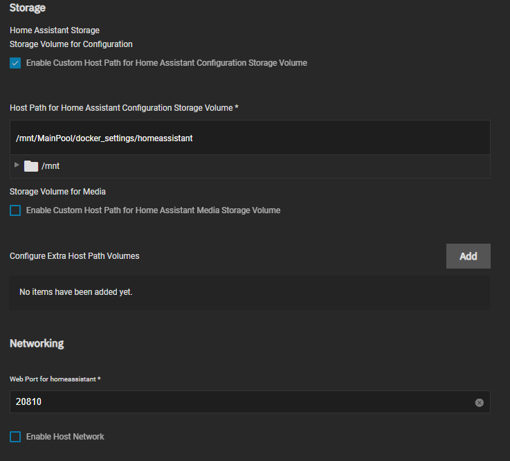

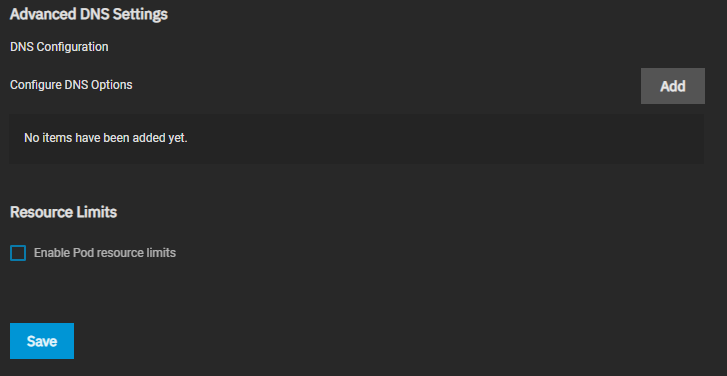

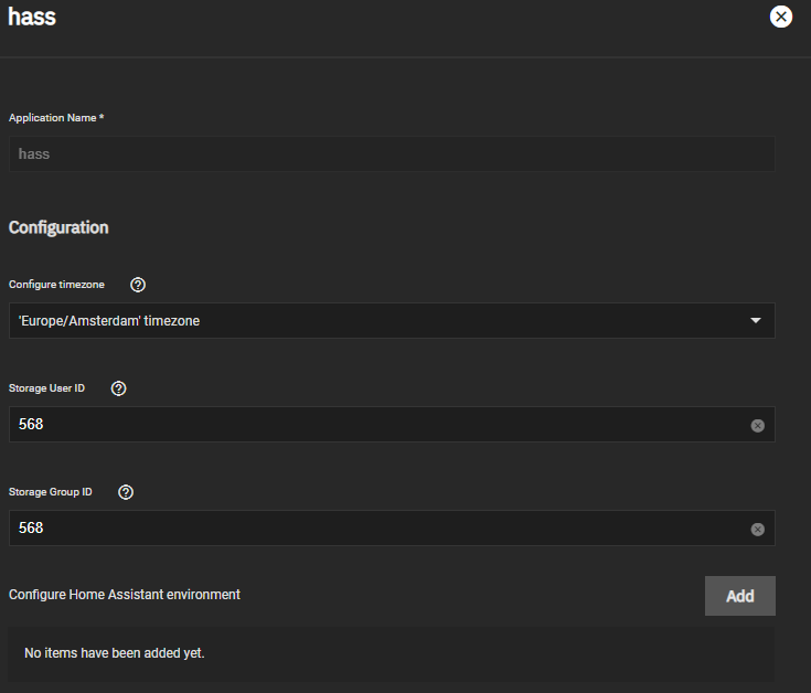

My app config is as follows:

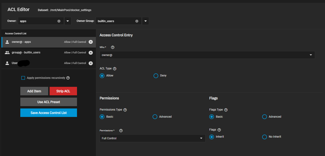

My dataset permission are as follows:
