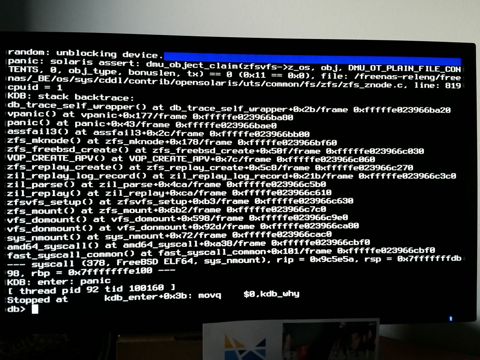

Tried some more. Hit a kernel panic this time. Photos of the messages.
Installing from DVD to USB. Selected destination drive in curses. Waited about five minutes. Panic.
