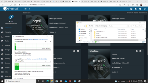

I made the plunge updated the drives and moved to TRUENAS. Everything seems to OK. Turns out I changed the 10Gb card to an Intel. To stress it a little I copied a couple huge directories from my FREENAS Server to my TRUENAS server to the other using a Win10 machine to set it up. It has a Solar Flare network 10Gb card. They are connected to an Aruba 2500 switch (has 4x10GB ports). FREENAS is not using the 10Gb Mellanox card but maxing out the 1Gb card on an HP Z400 MB. Why is the FREENAS using the 1Gb card vs the 10Gb card? I did a mount on the Win 10 system to the IP address of the 10Gb card. Here is a screen capture that shows that the mounted drive is 192.164.0.60 on the Mellanox card. The 192.164.0.61 is the FREENAS servers Intel IP address. What am I doing wrong?

NugentS
Apr 16, 2020
2,947
do you have multiple network cards on the same IP range?
Yes I use 192.168.0.51 for 1Gb card and 192.168.0.61 for 10Gb card or TRUENAS and 192.168.0.50 on 1Gb and 192.168.0.60 on 10Gb card

NugentS
Apr 16, 2020
2,947
Which explains your problem. You cannot have two NIC's on the same network with different IP's. Actually you can - it just leads to some strange issues like you are having where the wrong card is used.

Very interesting article. Yes I have done this on Windows, and expected this to work similarly. Now I know what I cannot do.
Is this what I need to do?:
To access my servers I should then put them on a separate subnet, say 192.168.1.51 for 10Gb and 192.168.0.51 for the 1Gb card. If I do the same thing for the second server 192.168.1.50 10Gb / 192.168.0.50 1Gb. To access the high speed subnet from my windows machines I will need to add a second IP address on the 192.168.1.X subnet to each of the clients? Some of the Windows clients have 10Gb cards as well, so those get IP addresses on the highspeed subnet. The DHCP server is on 192.168.0.1. Who provides the DHCP on the highspeed subnet? I realize if I go with static IP addresses I don't need, but trying to understand the implications of the separate subnet. Can I access the highspeed subnet from a wireless device if it is only on the slower speed subnet? I have never done anything that was not on the same subnet so please help. In Windows when I try to assign two IP addresses to a single card they both have to be static IP addresses?

why not just use the 10Gb network and not use the 1Gb. NAS on 10Gb connected to a 10Gb switch. Clients attached to the same switch can be either 10Gb or 1Gb (or 10/100, or 40Gb.........) and it will all just work

I see what you are saying. I guess I was too tentative that the 10Gb stuff will work. I wanted another method to reach the clients. I'll just uplug the servers from 1Gb network and give it a whirl. Thanks for being kind.
I disconnected the 1Gb cables and setup the FREENAS/TRUENAS servers only on the 10Gb. I found that the 10Gb cable that I was relying on was plugged into the wrong port and not configured properly. That is why I was not getting it to work without the 1Gb connection. Once I fixed that, everything is working. Performance is not much better than 1Gb for little jpg files. But much better for large movie files. Now I can benchmark and figure out how to boost performance. I'll search around for some advice. Thanks again.
Note: all 10TB from the old system are on the new system. Rate were up to 1.6Gb/sec. That's a copy though the 10Gb Win 10 Client so I guess that is not too bad.
