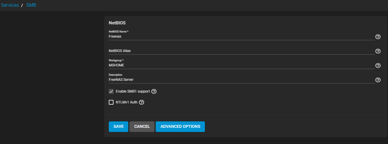

Here is a picture of the settings on the SMB. (Nothing has changed in my settings for years)

anodos
Sambassador
Mar 6, 2014
9,553
Nope!
It works with lowercase, first-letter capital, or all capital case
I haven't changed any settings since I set this server up years ago.
I'm referring to netbios name server being enabled in `Network->Global Configuration`. You can check output of midclt call smb.status AUTH_LOG | jq and make sure that your client is using correct credentials when trying to access using the netbios name. Windows clients can store different credentials depending on how server is accessed. This is especially a concern if "guest access" is enabled for any shares on the server.
