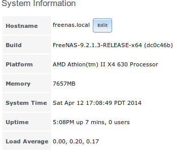

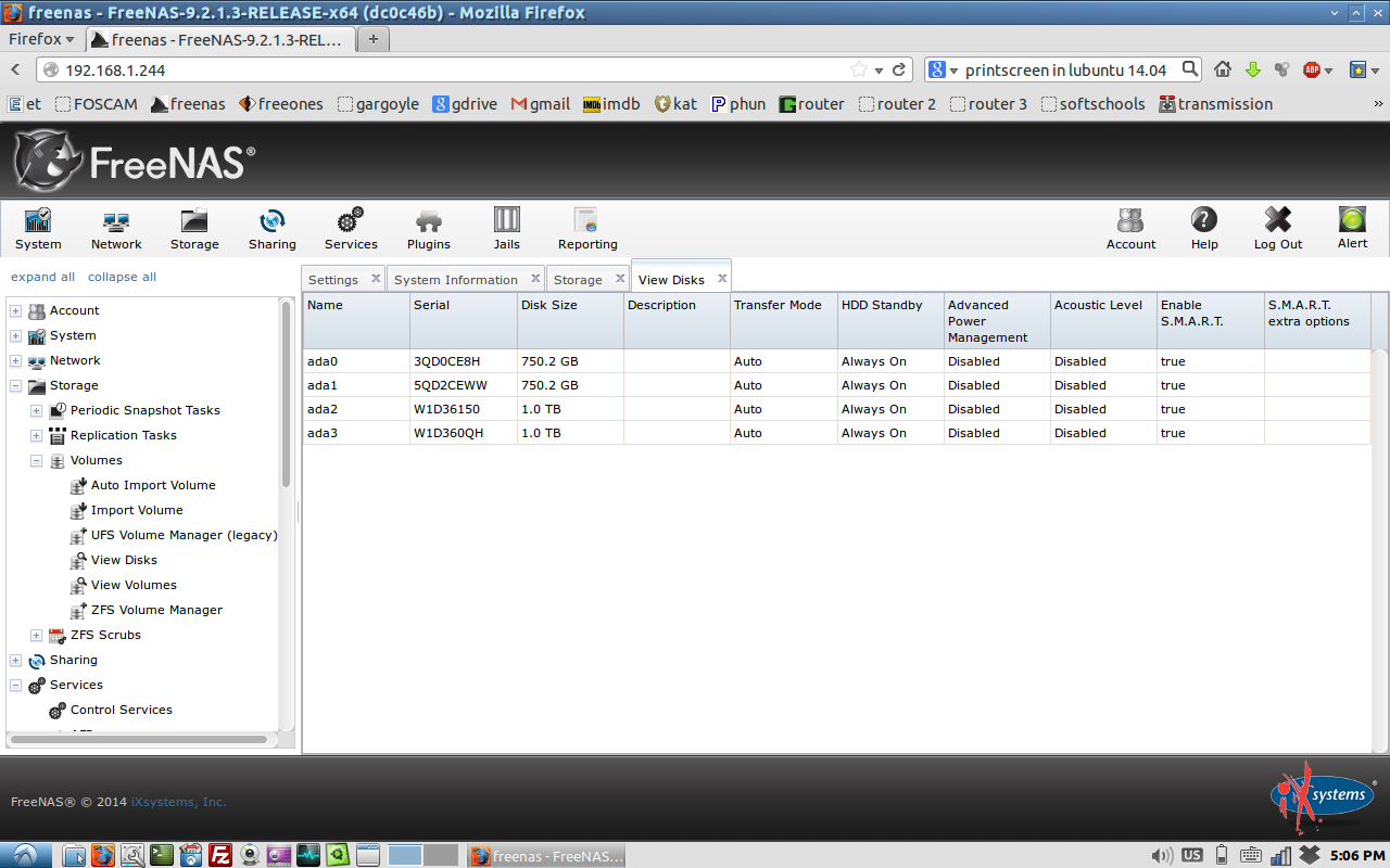

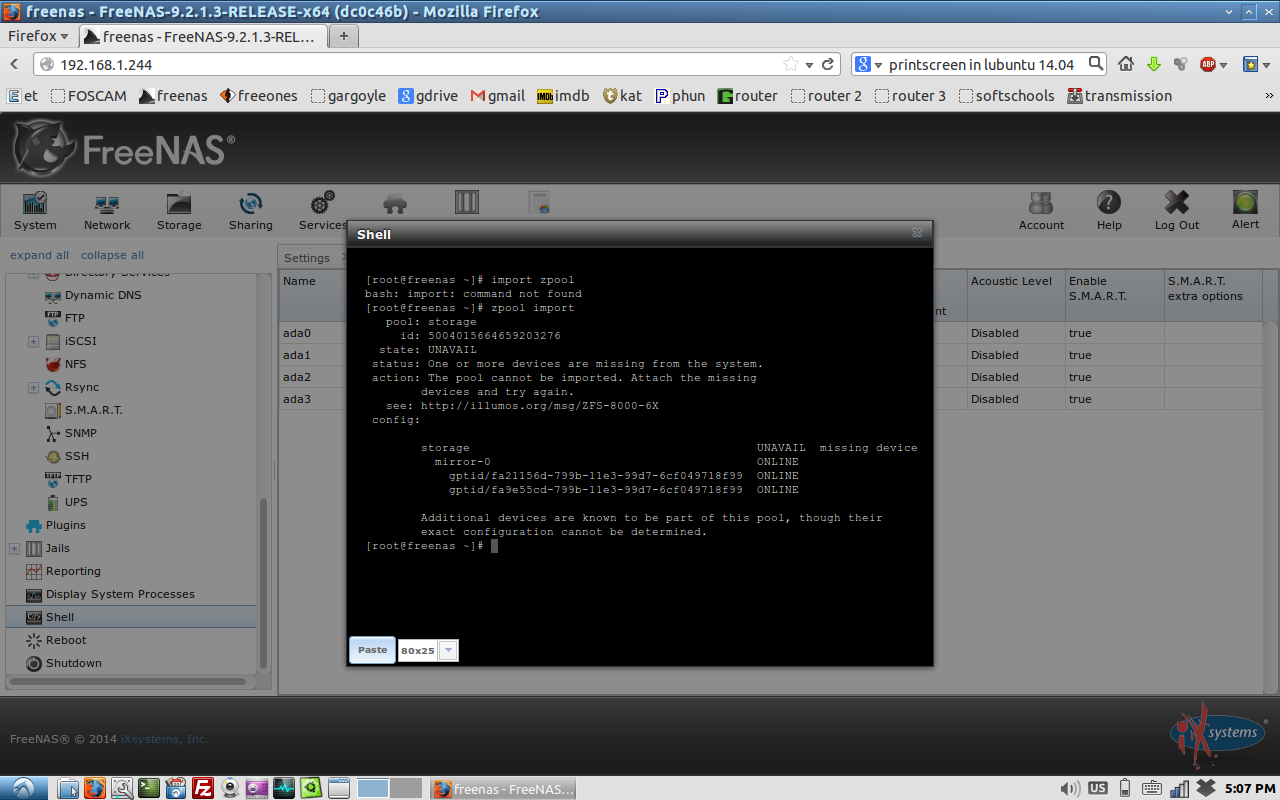

hi everyone. with much embarrassment to say that i detached my hdds because i added 2x 1tb hdds as jbod not as mirror to my machine. with the intent to reformat the 2 new drives i detached all of them. zpool status says there is no pool available. the four disks are visible but nothing can be done via gui, is there a way to remount the hdds via shell or root? ive attached some files for your reference. thanks to anyone that will help. this is the message from zpool import command.

Well, considering c0t0d0 is a non-FreeBSD/FreeNAS implementation, you've made a grave mistake by even choosing to use that pool on FreeNAS without creating it in FreeNAS.
As for recovery, I have zero advice. Nothing from the CLI is going to allow a pool to be mounted that is FAULTED. ZFS won't even attempt to mount a faulted pool because it has already determined it's unusable in its current condition.
I would say take the pool back to the OS you created it in and see what it says. As for using it in FreeNAS, I don't think you have a chance at this point. :(
