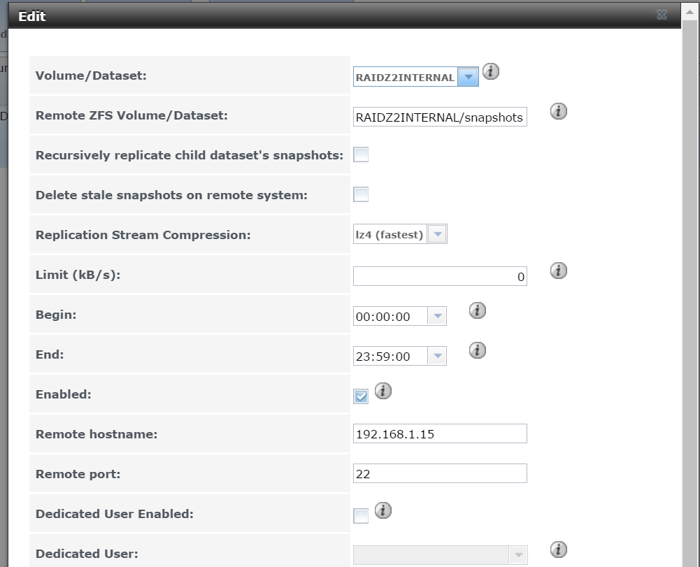

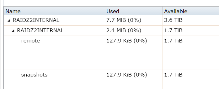

Well, I have snapshots working and that is good, but I can't seem to get replication to work. The source dataset is RAIDZ2INTERNAL. The source dataset name comes from the dropdown in the menus. The target dataset is RAIDZ2INTERNAL/snapshots (volume/dataset). I keep getting a message about the remote dataset doesn't exist. "Replication RAIDZ2INTERNAL -> 192.168.1.15:RAIDZ2INTERNAL/snapshots failed: Failed: cannot open 'remote': dataset does not exist". I have attached a screen shot of my source setup and my target set up for the replication. I am running 9.10.2 on both servers. I installed them both from the same CD. Does anyone have any idea what I am doing wrong? Thank you in advance.

Something weird is going on there. You have that remote dataset on the remote. Is it possible you have more than one replication task?
John Spiewak
Jan 1, 2017
9
It is possible I have some stuff messed up. I kept trying different things. I am going to clear it all out and try again. Hopefully, that will clear things up.
