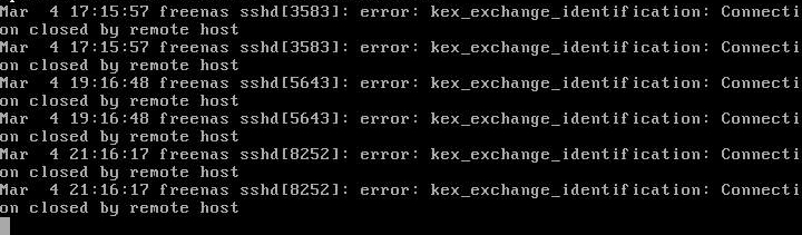

Hi folks - Maybe I never noticed this before, but every hour (on the half-hour, my timezone is GMT -2.5) I see the following in my logs:
Feb 16 09:30:13 freenas sshd[76681]: error: kex_exchange_identification: Connection closed by remote host
I do have an rsync backup task from my FreeNAS box to my old Synology NAS but those backup tasks are working fine...
Does anyone have any idea what this is?
Thanks
Mike

I have the same problem:
"error: kex_exchange_identification: Connection closed by remote host " :rolleyes:

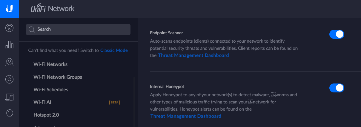

Hello,
I noticed same error message today:
I checked using tcpdump as explained here: Limiting closed port rst response...
Using this command:
tcpdump -n -v 'tcp[tcpflags] & (tcp-rst) != 0'
And I confirmed what I already guessed, this is caused by Endpoint security port scan of my UDM-Pro which is running at regular intervals:
Since the scan feature will try to connect to many ports, it will create those errors.
So I would say that you may have some device with a port scanner running on your network. If this is a security feature like it is in this case, everything is fine. If you're not aware of any legitimate port scanner on your network, you should check which IP is trying to connect to your freenas because you may have a hacked device somewhere.
