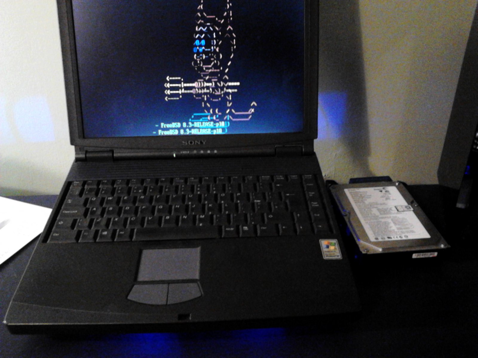

As I reboot, I catch a log entry: ZFS datasets requires min 516MByte RAM. As I develop my freenas as a home project I use a 13 years old SONY notebook and a 10 year old desktop PC HDD...(see picture) with 516 MB RAM but the freenas system sees only 495 MB. It can be a problem...

If your system has less than 2GB of RAM with UFS or 8GB of RAM with ZFS, you shouldn't be using FreeNAS. It'll be unstable and crash alot.
