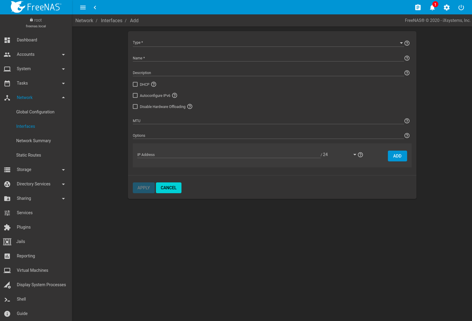

Hi Guys -
I've seen in the documentation I should have "Link Aggregation" menu item under "Networking" in the FreeNAS Web GUI on the left hand side ribbon. I don't seem to have this. I'm using FreeNAS-11.3-U3.2.
See a screenshot attached. I know I can set this up on the CLI, but I'm curious why is it missing? it seemed to be there in the documentation.
Any ideas?

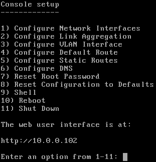

You can configure Link Aggregation either via the console menu:
or via Interfaces. Click the Add button, and then pull down Type to select Link Aggregation.

Go to "Interfaces", then "Add", then select LAGG as the type.

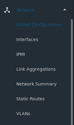

Excellent thanks for pointing our where this is hidden, the documentation I was looking at must have been out of date, it was shown Link Aggregation like in the attached along with some additional options.
