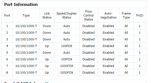

Dec 29, 2014
1,135
It seems, freenas/freebsd doesn't allow setting the marking of the vlan/lag with the desired pvid, or i am doing something wrong.
FreeNAS does not impose that kind of restriction. Problems are bound to occur in an 802.1Q link if there if both sides don't agree on the the untagged VLAN. It can get confusing because of different terminology. I don't have an Netgear stuff, but I have configured it for customers in the past. I am 99.9% positive that PVID means the untagged VLAN. That would make sense because there can only be one untagged VLAN. All other are tagged. This is a screen shot from an older HP switch, and I know in this case that PVID is the untagged VLAN.
