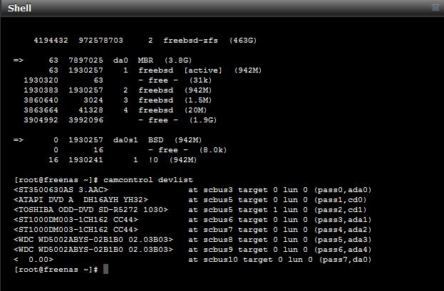

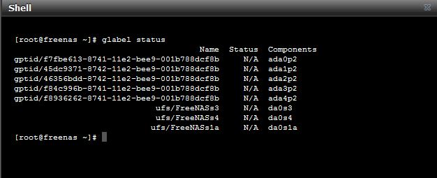

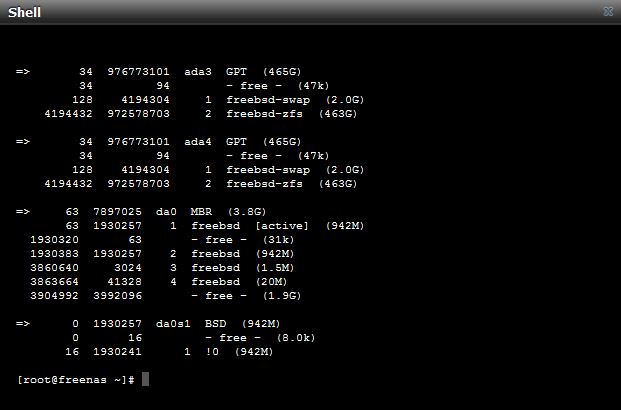

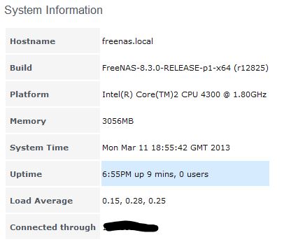

Hi there, I'm completely new to FreeNas (and loving the potential - just for home storage and backups - old pc c2duo1.8gHz, 4Gb RAM, 2x1tb - mirror, 3x500gb - RAIDZ2 (total 1.3Tb storage available) sata card (will add more drives when cash is available)
I am having an issue with crashes of the system when copying data across - data still there after hard reboot of the NAS - sometimes takes a few goes. and would like some help finding out whether its a hardware or setup issue. Not sure how to get to the logs (how to show them here would be a great help), but have some info from other posts that may possibly help get to the bottom of this?
Here are screen clips of some of the output - SPEC.JPG CAM.JPG GPART.jpg NAS2.JPG
Any advice/help is greatly appreciated.

Well, you have 4GB of RAM, but only have 3056MB of RAM available to the system because of PCI reservations. As the manual suggests, you really should have at least 6GB of RAM to use ZFS + 1GB of RAM per TB of data. 6GB of mentioned because you often lose 512MB to 1GB for the PCI reservations alone.

Bit of a typo on my part, there is only 3056Mb RAM in the system (hopefully more memory on the way later today, real pain as the box is an HP old and will only take ecc RAM, also a cpu upgrade, found a spare 2.4 Duo in my bits box last night). I'll add that and see what happens as I still have a fair amount to copy through. Would still like to be able to get someone look at the logs, if there are any instructions how to export that.

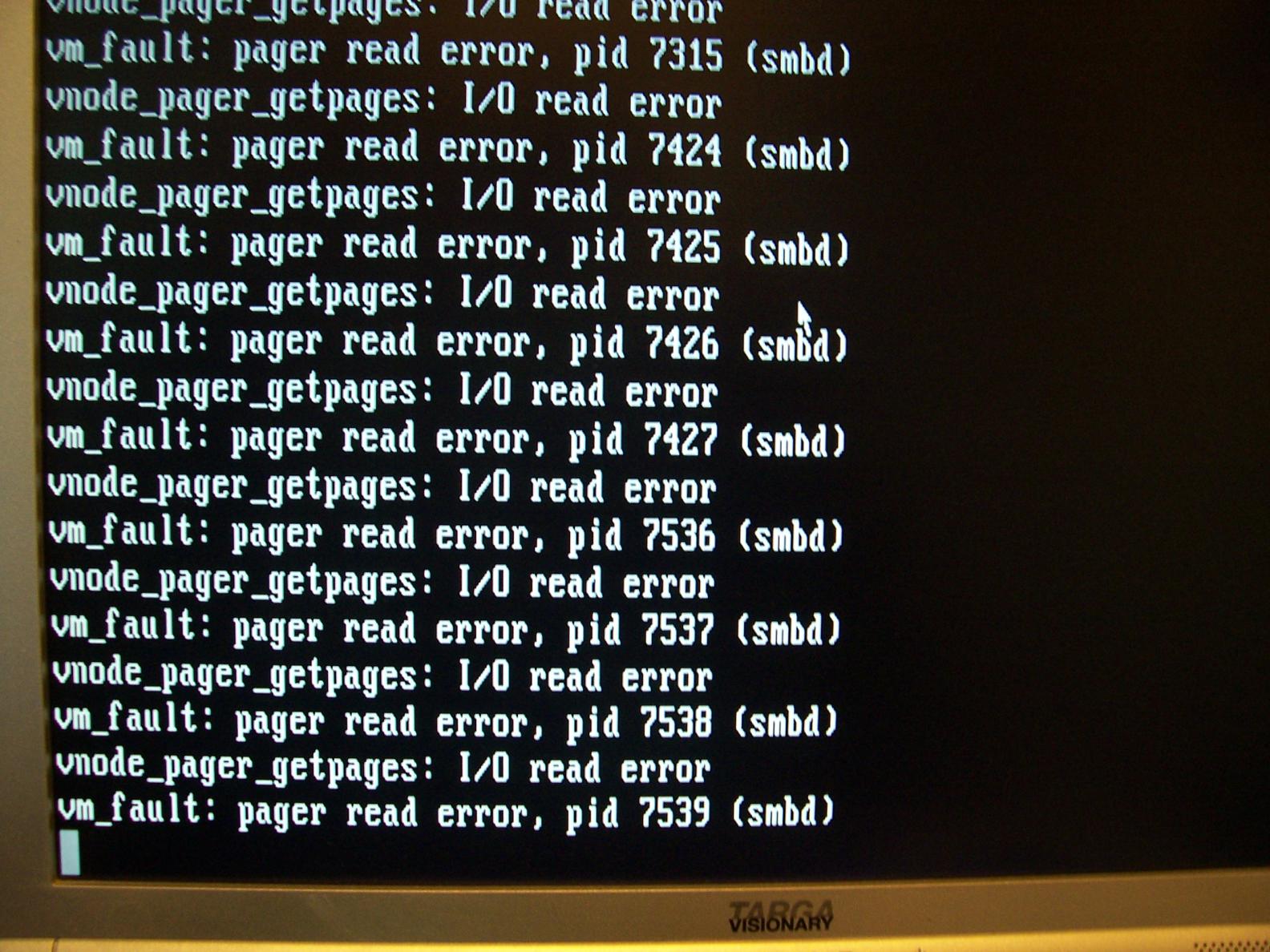

gpsguy
Active Member
Jan 22, 2012
4,472
Hook a monitor up to the server and see if it displays a message on the screen when it crashes. If so, snap a picture, cellphone or whatever, and include it with your message.

ok, will have my kvm connected tomorrow, I have hooked the monitor up a few times and seen different errors - one just scrolling lines about io error, another that I couldn't make out and one that I managed to write down -
UMASS0: AT UHUB4 PORT 6, ADDR2 (DISCONNECTED)
(DA0:UMASS-SIN0:0:0): LOST DEVICE -0 OUTSTANDING. 1 REF
(DA0:UMASS-SIN0:0:0): REMOVING DEVICE ENTRY
DEVICE FREENAS4 WENT MISSING BEFORE ALL THE DATA COULD BE WRITTEN TO IT : EXPECT DATA LOSS
/DEV : GOT ERROR 6 WHILE ACCESSING FILE SYSTEM
PANIC: SOFTDEB_DEALLOCATE_DEPENDENCIES : UNREMOVED I/O ERROR
CPUID = 0
KBD: ENTER PANIC
[THREAD PID 7817 TID 100126]
STOPPED AT KBD_ENTER+0X3B:MOVQ $0,0X74CFA2(%RIP)
I'm really not sure what device that's referring to, could it be one of the drives or maybe the USB drive that I have installed the o/s on??
