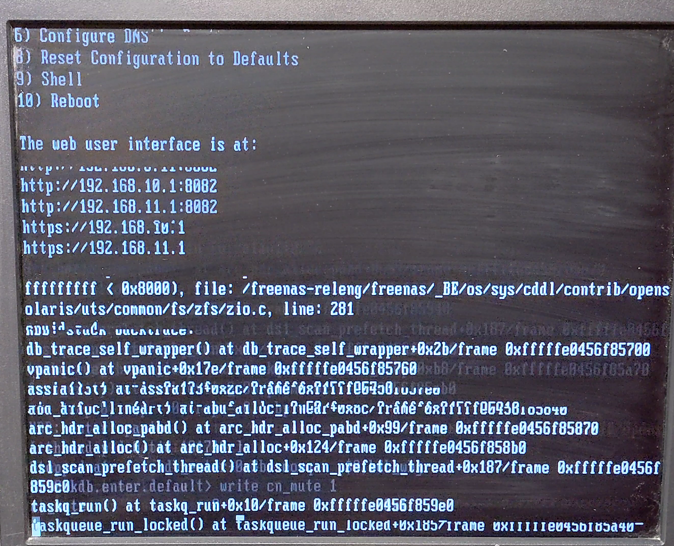

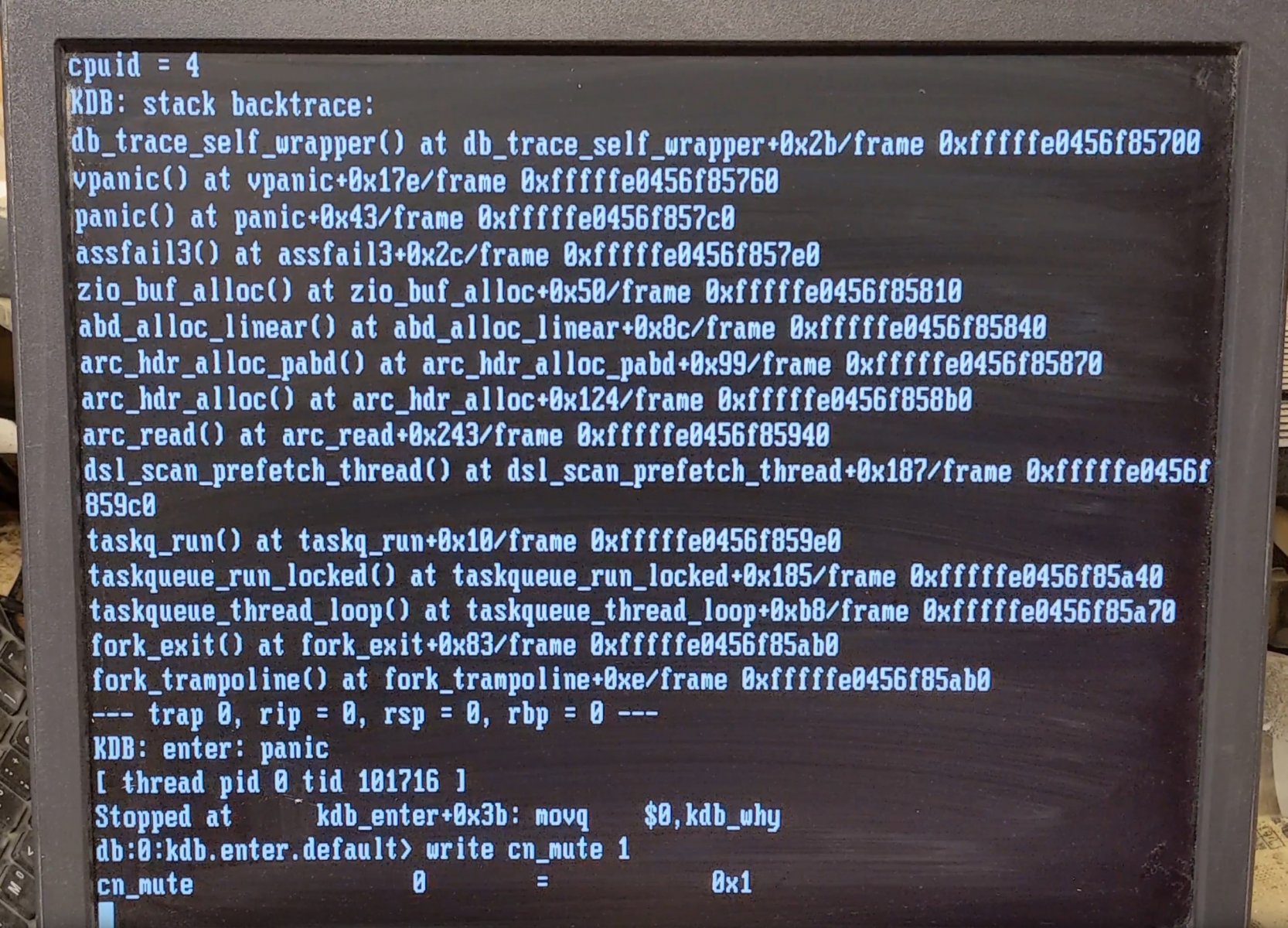

I connected a head to try and get some idea of what it was doing during the failure, the error flashes up pretty quick so I had to video it to be able to read it, but I think that it says something like:
“fffffffff 8x8800), file: /freenas-releng/freenas/ BE/os/sys/cdd1/contrib/opensolaris/uts/common/fs/zfs/zio.c, line: 281
cpuid 4
KB: stack backtrace:
db_trace_self_wrappert) at db_trace_self_wrapper x2b/frame exfffffe0456776798"
(see attached screenshots)​

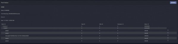

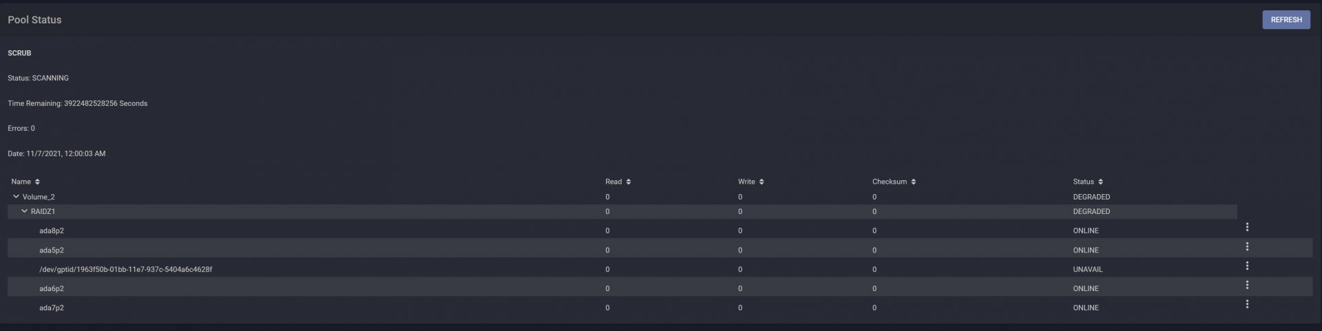

I followed jlpellet's advice and tried disconnecting individual drives in the Volume_2 pool.
When all but one of the drives (ada9P2) were connected, the pool still showed as unavailable and the system was stable. When ada9P2 was connected and one of the other drives was disconnected, the system would boot, recognise that the pool was in a degraded state, and then reboot on a cycle as before.
Disk Removed
Volume_2 Accessible
System Stable
ada9p2​
YES (DEGRADED)​
NO​
ada6p2​
NO​
YES​
ada5p2​
NO​
YES​
ada7p2​
NO​
YES​
ada8p2​
NO​
YES​

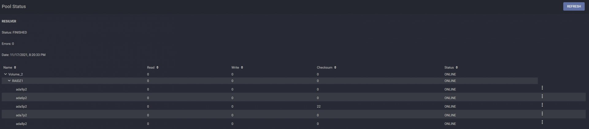

The weird thing is, once I had cycled through disconnecting all the drives, when I came and connected them all up again, the system recognised the Volume_2 pool and stayed stable. So I now have full access to my pool again. I have been backing it up since.
When I checked the pool status after reconnecting all the drives, it said that a resilver had finished.
Can anyone help me shed some light on this sequence of events? given that the pool is a RAIDZ1 I would have expected it to read as degraded when any of the drives were disconnected.
