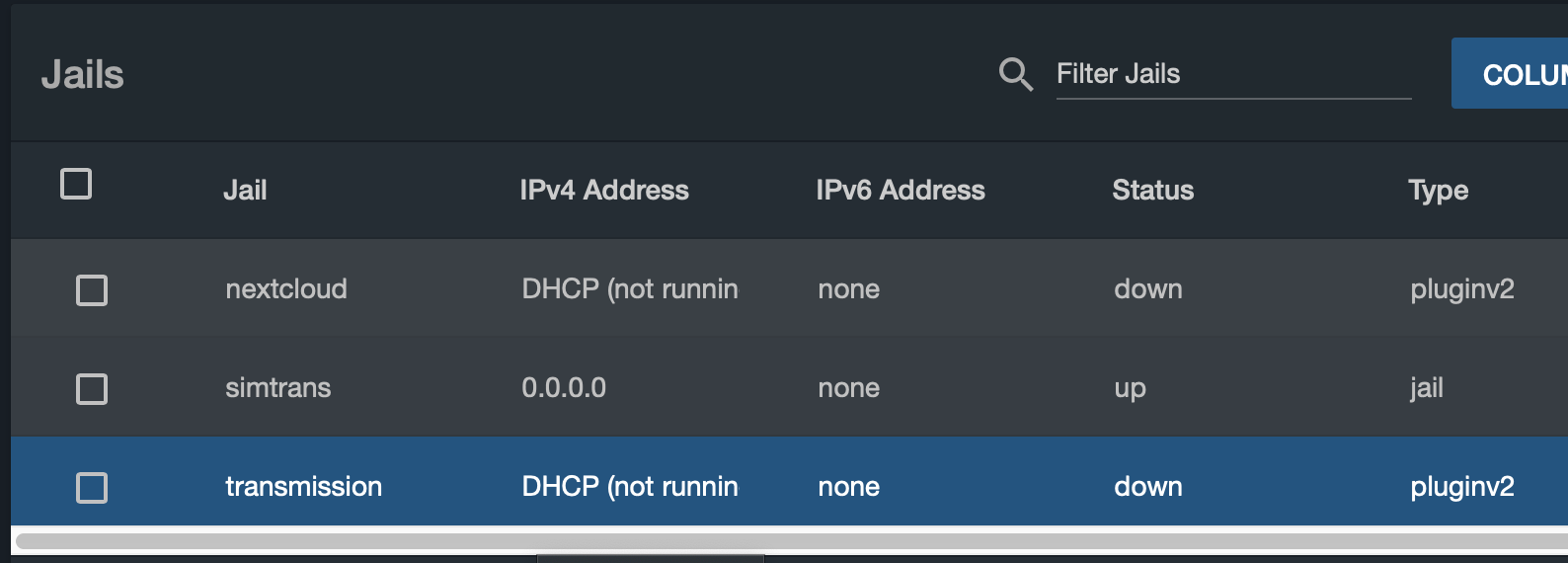

I have two plugins and one jail. The come and go as the wind... Sometimes they are there, but don't get IP (either get "DHCP(not running)" or just "0.0.0.0". When nothing shows on my jails list, I fire up the shell and check with jls, then only the jail-jail (ie., not a plugin) will show up.

I am not seeing any errors. They, ie. the jails, just come and go. Attached is a list of the jails. They are not getting ip's. My list of installed plugins also sometimes get emptied, with an error (the only explicit error I get) saying the index is out of range or something.
