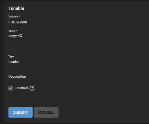

Related to limit, I set it directly into loader.conf?
I don't see a way to define the jail into TrueNAS menu:
