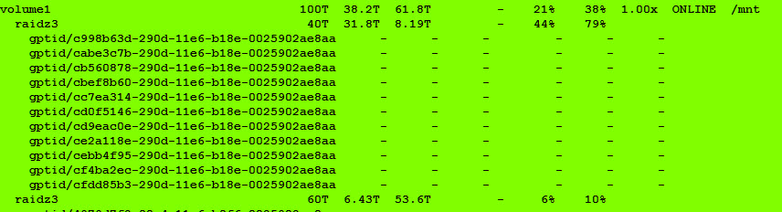

philhu
May 17, 2016
258
ok, so watching the numbers. As you said, it is writing mostly to the vdv1, almost empty storage as shown below. But it IS writing about 10% of new data to vdev0, which is getting very close to the 80% mark, which is not the best. I know it is automatic, but doesn't seem quite automatic. The old has gone from 9.78T free to 8.1T free. New data written, about 8.1T, 1.7 to old vdev, 6.4 to new vdev
Should I manually move about 5TB to the new storage? Easy to do, copy to new data set, which will mostly write to vdev1, delete old datathen 'mv' data to current folders.

Bidule0hm
Server Electronics Sorcerer
Aug 5, 2013
3,710
It is, it's just that it still write a small part of the data to the old vdev rather than not writing anything to it, it's not a brickwall rule.
That's what I'd do ;)
philhu
May 17, 2016
258
ok, first test.
Moved 1.3T to a new folder, using 'cp -RPpa A* ../newA', watch it write mostly to vdev1, good
deleted the old data, that was on vdev0, 'rm -rf ./A*'
moved the data using 'mv ../newA/A* ., worked fine
So here is the result, the vdev1 DID increase 1.3T, but, the vdev0 did not decrease, probably due to shadow copy setup. Will the old just expire? Or do I need to do something for force it to be really deleted?
jgreco
Resident Grinch
May 29, 2011
18,680
Unless you are absolutely desperately in a crisis due to IOPS imbalance, you're really better off just not worrying about it and letting ZFS do its magic over time. Storage admins have gone insane obsessing over IOPS balancing.
philhu
May 17, 2016
258
Well, what I think I am seeing is ZFS NOT using 'set in stone' tech. For it to write 10% to a disk at the redline of space usage 78%+, when the other is 93% empty, seems wrong. I am moving over a bunch this weeekend. I do NOT want to get in the situation where vdev0 goes to 90% and then all hell breaks loose.
jgreco
Resident Grinch
May 29, 2011
18,680
No. You can be at 99.9999723% full on the a single vdev pool and unable to allocate new blocks because ZFS can't find any, then add a second vdev, and you're golden. There is no "redline of space usage" per vdev. It is per pool.
ZFS knows that it should try to balance writes between devices where at all possible, so even though there is a space imbalance, it still tries to allocate some space on that first vdev, knowing that when deletions happen from the pool, that's likely to mostly affect the first vdev. Over time, this causes balancing to happen much more quickly. No need to fight the process. ZFS knows what it is doing.
philhu
May 17, 2016
258
ok, that sounds reasonable. I will run for a week and see where we get :)
Ok, feel better. The vdev0 got to approx 80% and it stopped doing any writes to vdev0, writing as far as I can tell, only vdev1 at this point
