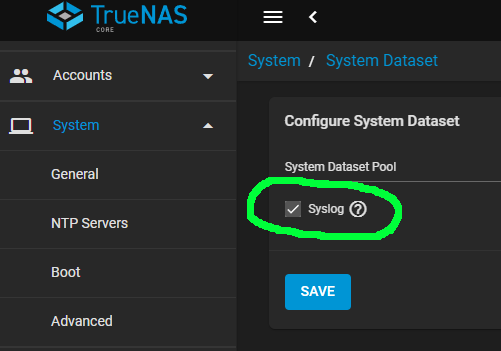

This is the setting you need to enable in Core. It's probably similar with SCALE. (The menu navigation might be different.)

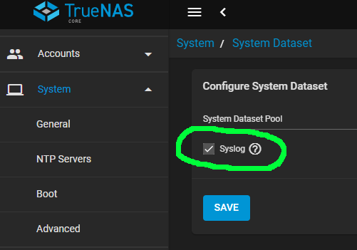

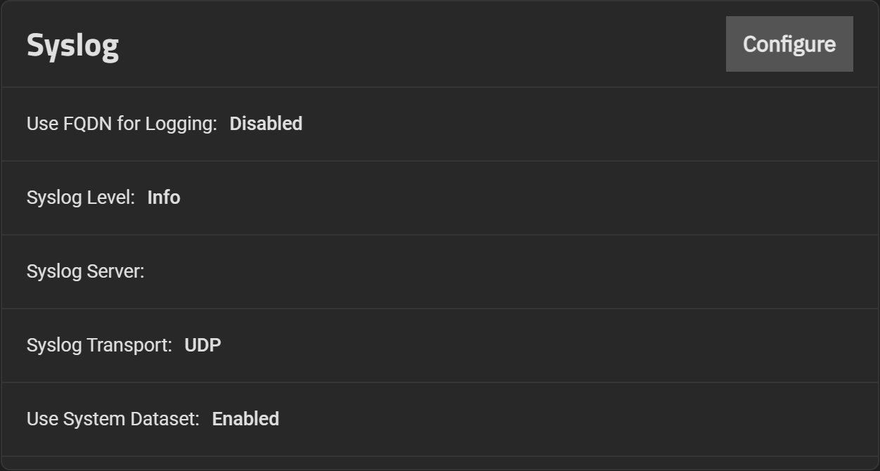

I do have that checked (it's in System > Advanced > System Log > Use system dataset for Scale) but still the syslog is cleared every time the system reboots. Am I misunderstanding where to find the syslog?

It’s the current beta version of Cobia
I think this might have something to do with this:
You might have to disable the option to store the logs to the System Dataset. It could be an "incomplete" feature in Cobia. Maybe they forgot to remove the option...
anodos
Sambassador
Mar 6, 2014
9,554
Regarding Cobia BETA - the webui option is currently a no-op. The systemd journal is on tmpfs / volatile, syslog-ng handles writes to /var/log (and other places as-needed). There is no code path to remove files from /var/log and it is on ZFS (not tmpfs).
If you can reliably reproduce cases where logs on /var/log aren't being preserved on reboot, please file bug ticket for developers to investigate what is going on.
ULTIoNT
Jul 14, 2023
24
That does seem to be related. I do observe that there is constant write to the boot drive although that's not where the system dataset resides. As anodos said the option is a no-op, so I guess disabling it won't make a difference. I will go on and file a bug ticket.
