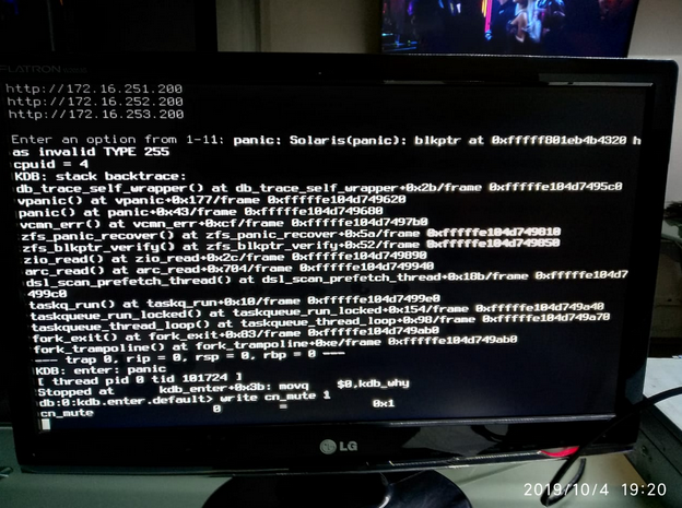

I updated from the GUI the base os and 2 other packages today in the STABLE train.
I neglected to save my config - that will teach me (again).
The system did a db schema update, rebooted again.
Stopped at ...
KDB stack backtrace... see image attached.
I rebooted and tried the previous build in GRUB. No difference.
There was no power failure here. this was an upgrade from inside the 9.3 STABLE train updates tab.
Any help would be really appreciated.

amtz83
Sep 11, 2014
Hi folks ! I have a similar problem but my FreeNAS start good, the menu appears but after 5 minutes aprox it is rebooted and show the message of image, my enviroment is a dell server 2 array one of them is raid1 of 2 tb where freenas is installed and another is raid5 25 tb memory 16 GB, the version was 11.1 U4 and I upgrade it to 11.2 U4 and is the same problem.
Can someone help me please ?
