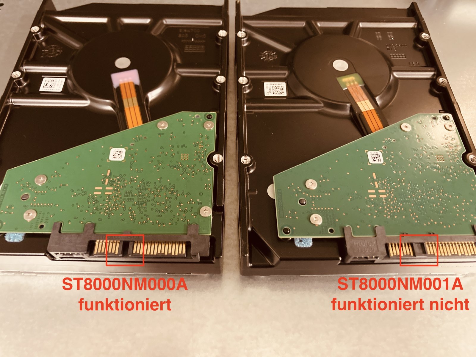

We run a couple of Fujitsu RX1330M2 machines. These are rather dated, but they have great power efficiency and reliability.
If you click on the third picture in the slider - that's the configuration. 4x 3.5" SATA. So far so good. A disk drive failing we replaced the drive with a new one of the same model (it seemed). The new drive would not be recognized by the machine. At all.
When plugging in there is a short flash of the HDD indicator light, but that's it. Not probed in FreeBSD, not recognized in the BIOS setup, nothing.
What I found today is that the old drives in this machine are ST8000NM000A while the new drive is of model ST8000NM001A. I took a picture of the connectors.
The ST8000NM000A does work while the ST8000NM001A doesn't. Does anyone have an explanation for this subtle change? Looks like the plug on the backplane doesn't give way for the second connector and because there is no gap pushes it up just so slightly. The HDD can be inserted without excessive force just fine. But the contacts are obviously not touching their counterparts.
Is there any standard term for this "feature"? How can I make sure other drives, possibly from other manufacturers, I buy in the future have the connector on the left?
