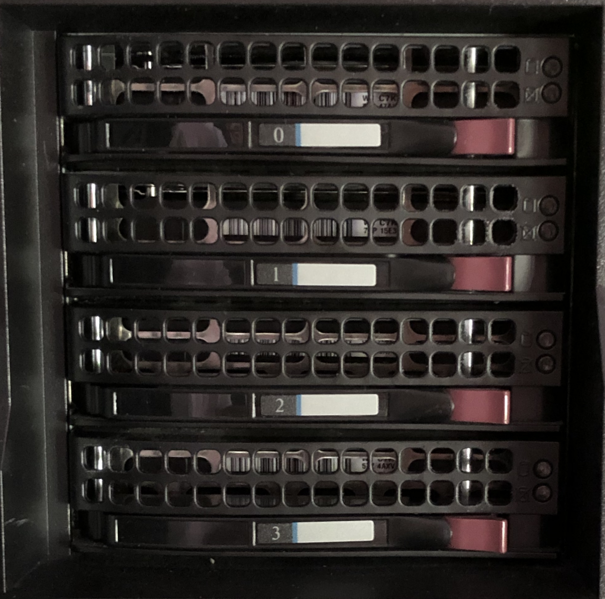

I run this Supermicro chassis:
With this mainboard:
Now as you can see in the picture the drive trays are neatly labeled and the individual bays are connected to SATA connector 0 to 3 on the board. Consequently the disk drives are ada0 to ada3.

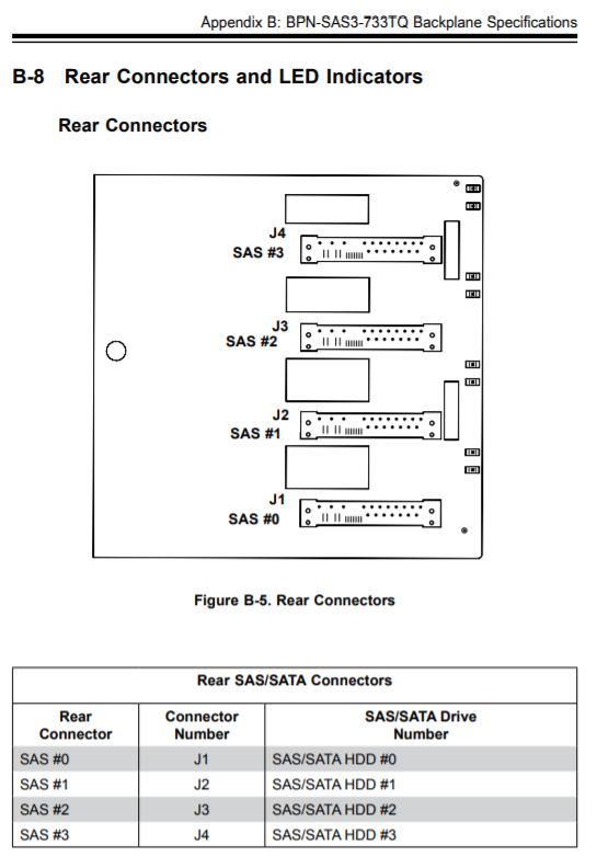

When I do something like
dd if=/dev/ada0 of=/dev/null
I can easily identify the drive and so I know the trays match the logical numbering of the drives.An then I learned about

sesutil locate ada0 on
the wrong trays are lit. The wrong way round. ada0 for what should be ada3, ada1 for ada2. So I am wondering if I just need to switch the on-board connectors? How does the device know which disk is in which tray, anyway? Is this just hardwired for a small system like mine?Equally confusing:
