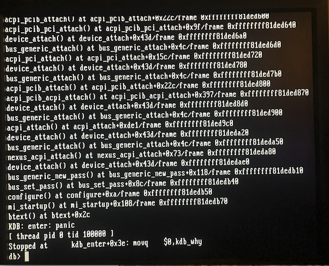

Hi Jimmy
How did you manage to install FreeNAS onto a SuperMicro 1028U with Intel NVMe P3700 ?
I have tried installing on 4x P3700's and get the same error every time.
The installer stops at a point and shows this error :
KBD: enter : panic
[ thread pid 0 tid 100000 ]
Stopped at kdb_enter+0x3e: movq $0,kdb_why
db>
Any ideas what it is ?
Do we need special settings in the BIOS ?
I have the latest BIOS loaded ver 2.0b
Thanks in advance
Vince

Vince, it could help if you shown more of the panic context. And possibly typed `bt` command after that.
Hi MA,
See attached screen shot of the full panic.
I tried to type 'bt' but the keyboard has frozen ??
Can you make any sense of the screen shot ?

`bt` is a short version of `backtrace` -- actually the same as shown on the first part of your panic screenshot. Unfortunately the most interesting part of the panic didn't fit the screen. From provided I can only tell that it happened during device probe/attach process.
Ok , so is there anything I could do ? is there a new NVMe driver for FreeNAS 9.10.2 ? I am no Unix expert :-( , would there be a way to inject the new driver before the installer kicks off ?

Sorry to dig up an old thread, but I'm curious to see if anyone can help with this. I am getting the same panic message that Vince got. I'm running a Supermicro 2028U-TN24R4T+ with 4 Intel P3520 1.2TB drives and now 4 Intel p900 280GB drives. I originally had 1 p900 drive and everything functioned fine. I added the 3 other drives and I got the panic. I removed the three drives and tried booting with only 1 attached of each of the new drives and it booted just fine. Add another drive and I get the panic. If I add the drives in after the system boots it restarts on it's own.
I'm in the process of updating to the newest version of FreeNAS to see if that will sort out of the issue, but any advice in the meantime would be excellent!

I had the same issue originally. I had to add these loader tunables:
hw.pci.enable_msi = 1
hw.pci.enable_msix = 0
After that, the system boot and ran without issue.
