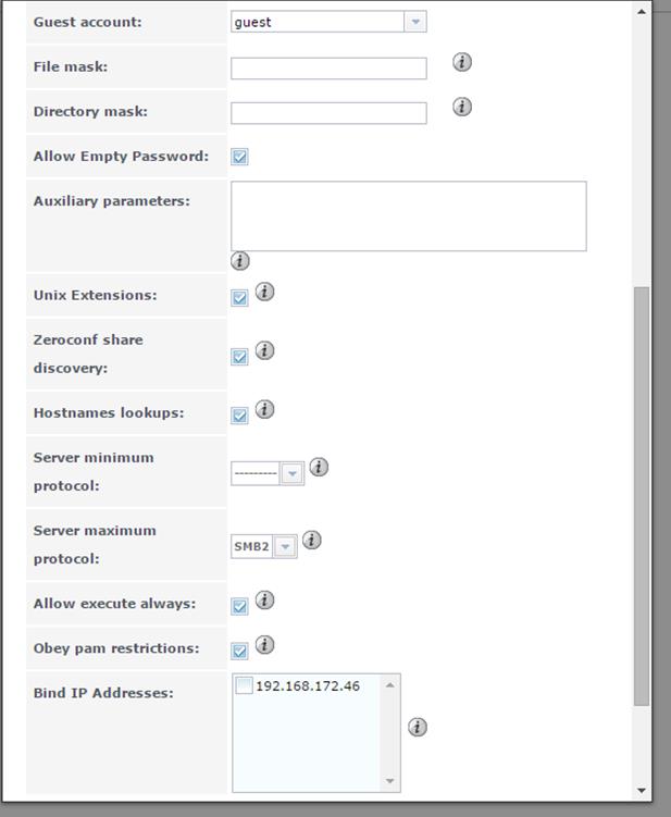

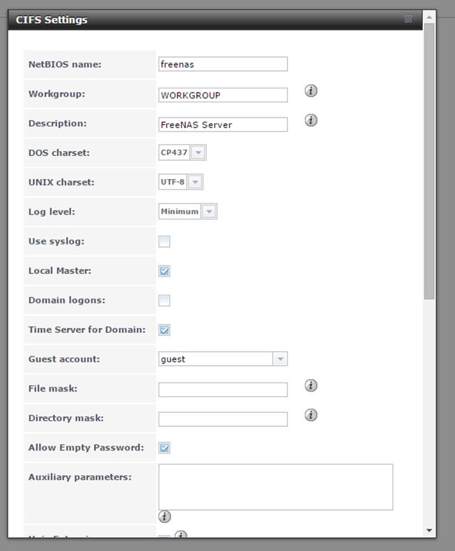

What is your minimum and maximum protocol version for cifs? It's in the cifs service settings.
Johev
Nov 26, 2014
107
Minimum is set at nothing and maximum at SMB2 and the guest account is a guest that I have created and mapped to a group called guest already included in the initial accounts created by Freenas. Please see the print screen attached.
Many thanks :)

SweetAndLow
Sweet'NASty
Nov 6, 2013
6,421
Hmmm... Everything looks OK. Can you post your debug file? That will have all your permissions in it to double check.
