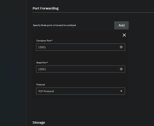

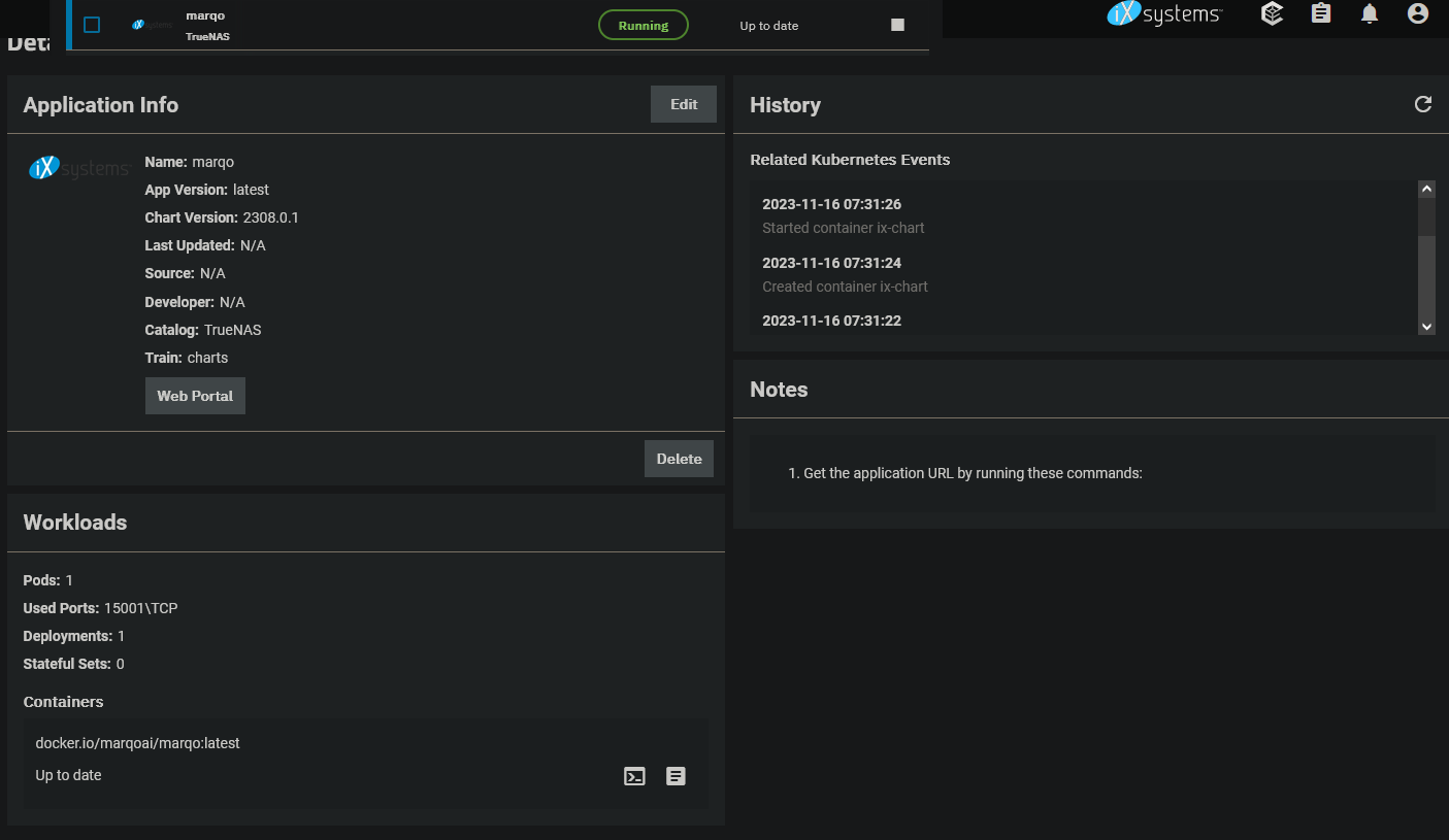

I'm wondering if someone could help me set up a Docker container in Cobia. I am hopeful there is a way to get it working in TrueNAS, although so far I am unable to connect to it.
The container I am trying to set up is this one: https://github.com/marqo-ai/marqo , and this is their recommended setup:

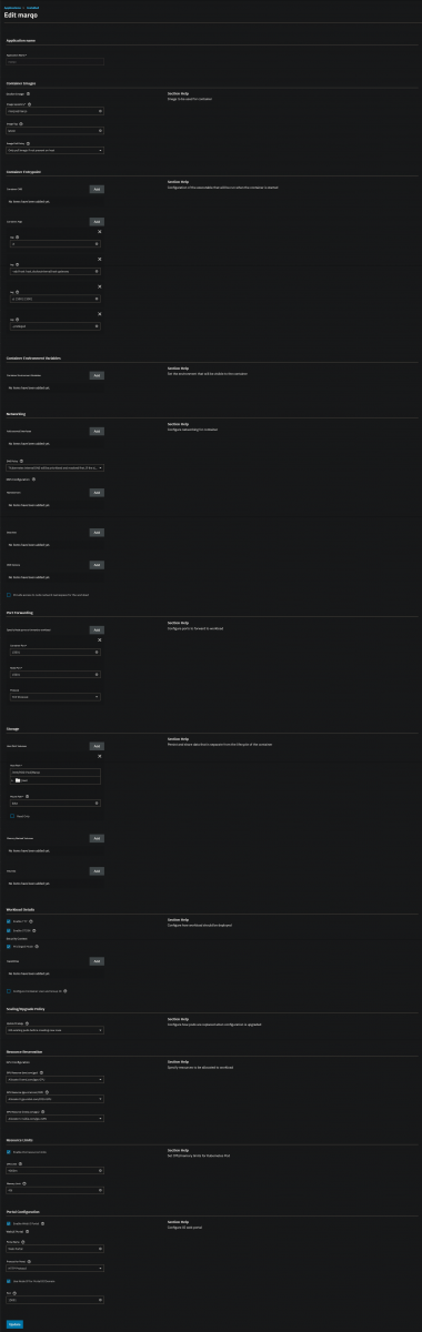

Setting it up a custom app in Cobia, I can pull it and start it fine, but am unable to communicate with it, so I was hoping I was just doing something stupid and someone might be able to help me figure out what I did wrong or let me know if it is even possible to get it running properly. Below are my settings (IMGUR backup link: https://i.imgur.com/9OFClHk.png).
I know some of those args won't work, but I was starting to just try anything to see if it had any effect. The container starts and says it is running, but I cannot communicate with it. Normally it spits out a bunch of logs in Docker as well, and I am not able to see any of those in TrueNAS. You should be able to just send it a request to get a response from it, but it refuses all of my connection attempts (either from TrueNAS machine or from other devices on LAN).
docker pull marqoai/marqo:latest
docker run --name marqo -it --privileged -p 8882:8882 --add-host host.docker.internal:host-gateway marqoai/marqo:latestSetting it up a custom app in Cobia, I can pull it and start it fine, but am unable to communicate with it, so I was hoping I was just doing something stupid and someone might be able to help me figure out what I did wrong or let me know if it is even possible to get it running properly. Below are my settings (IMGUR backup link: https://i.imgur.com/9OFClHk.png).
