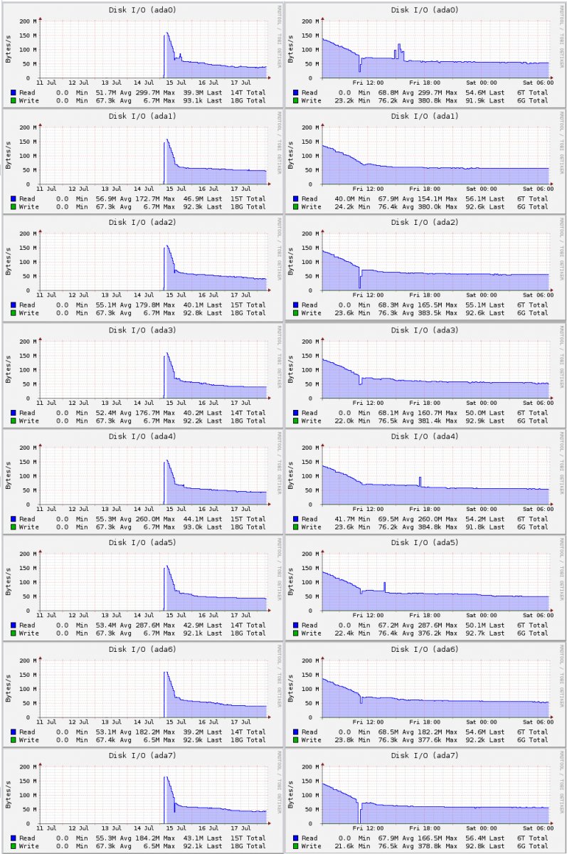

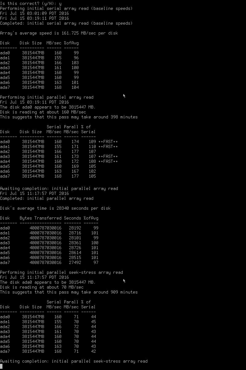

Hey Guys,
I'm running @jgreco's stress test script and these are the results so far:
Couple questions....
1) The script says that the parallel seek-stress test should take about 909 minutes. So far it's been going for almost 3 days. Is that normal? How long does it typically take to complete a pass with this script?
2) The drive speeds are kinda all over the map and ada0 and ada2 seem to be jumping around more than the other disks. Is that normal?
Thanks :)
You might want to see if the dd processes are still running and what's going on. Log in with ssh from another system and take a peek with "ps" and also look at any results files happenin' over in /tmp. The script isn't suuuuuper intelligent about handling bad disks or exceptional conditions if something's wrong. If one of the disks was racking up a large number of errors, that might explain, so also roll back the I/O graphs and see if any disks dropped down.
The parallel seek-stress is, though, I think the test where it failed to include a multiplier in the time estimate for the number of simultaneous tests. So if you roll back the I/O graphs in time and they look as pretty as the ones above, you're golden. It should take around 6 * 909 minutes (5454, or 3.8 days) to finish. You should really tell me how badly I suck and how I ought to go fix that. :smile: Seriously.

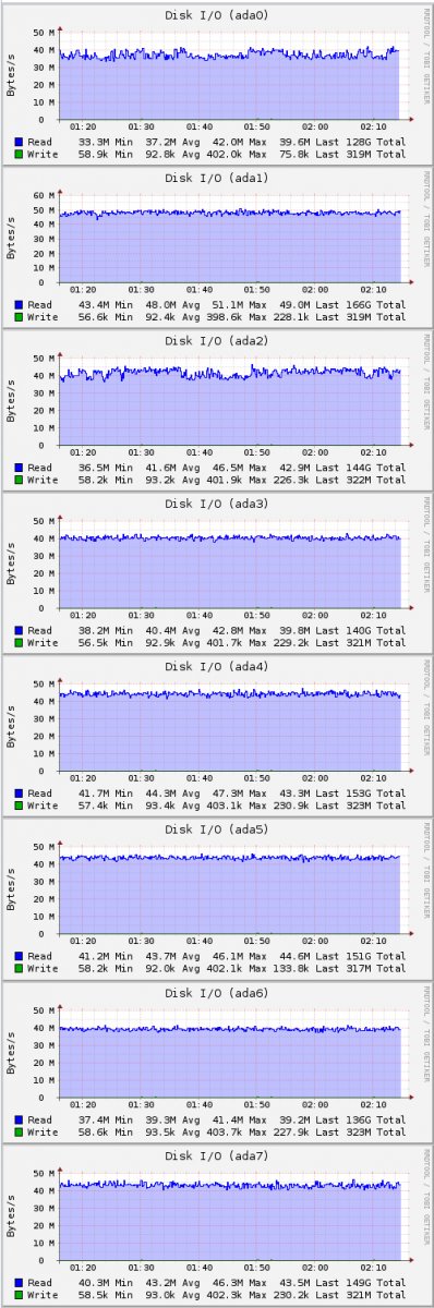

Yeah, more or less. Drives are physical devices and can have their own personalities. It could represent two drives that simply have a slightly more difficult time "settling in" on a track after a seek. It's good for you to notice the issue, and then maybe follow up with some SMART stats inspection to see if anything appears out of the ordinary. The tool is absolutely worthless for that sort of problem detection, but then again its purpose is to free up the user from the lower level stuff (which is just such a PITA to do by hand) so that you can go off and get handwring-y about this sort of thing.

Thanks for the reply :) OK, forgetting a multiplier on the time would definitely explain the problem and would mean that we're still within an acceptable time limit for this job :) Looks like it may be done soon.

There may be a spot where a couple drives dropped out while the other ones didn't but I think that may be where one of the tests stopped and another one started.
Yes, that'd be where the initial read test happened. This all looks fairly reasonable.

Cool! Well, if all goes according to plan this script should be done by about 9pm tonight. When it's done I'll run some SMART tests :)

This bloody thing is still going.... o_O:confused:
I took a look at your code but my noob eyes weren't able to find any mistakes. The code for the parallel test looks very similar to the seek-stress test.
How hard would it be to write in a % complete status update as the test is running? Once this pass completes I'll probably stop the script and run some SMART tests so I can test any changes you may like to try ;)

Alright, it finally finished. For those who may be wondering, this test took 7days and 3 hours to complete a pass on 8 4tb HDDs.
Unfortunately there isn't a good way to export drive reporting statistics from FreeNAS but, basically, for the seek stress read test, the read speed started out at about 100-150mb/s and slowly ramped down to about 15-20mb/s before jumping back up to 100-150mb/s and then the test ends. If you see your drive speeds jump back up the test is almost finished.
Also, I kinda figured the test would just keep running indefinitely but it does stop and return you to the command prompt after completing a pass.
