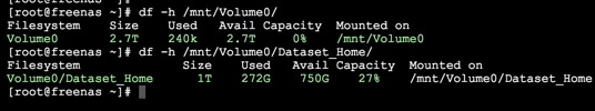

I'm trying to upgrade from 9.2 to 9.3 via the GUI.
I've selected the pool as the place to temporary stores files, however the upgrade process fails with an error saying:
upgrade_fail 'Root device too small!'
I've read posts mentioning the minimum dimension for external devices to be 8GB but in this case I'm using the internal pool.
The GUI only lets me select /mnt/Volume0
however it is shown with no capacity left (while obviously the contained datasets have space available)
Do you know if there is still a way to do the upgrade w/0 using an external device?
thanks in advance
